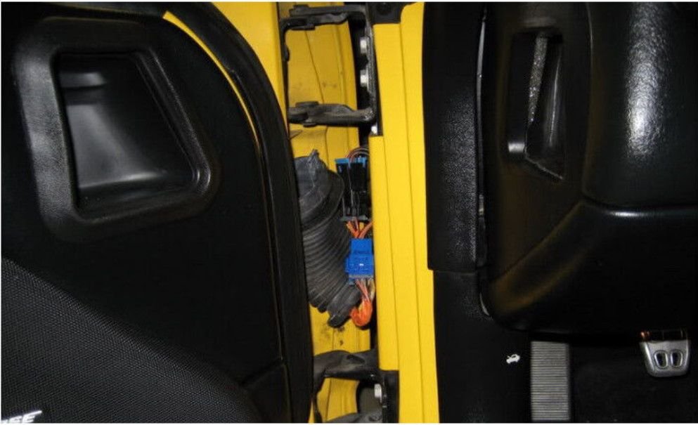

It can be a serial data bus issue .
Try wiggle these cables/connectors in both doors and see if you get any response .
You should also inspect these connectors , They should all look like upper left to avoid contact problems .
The upper middle contact will cause problems
