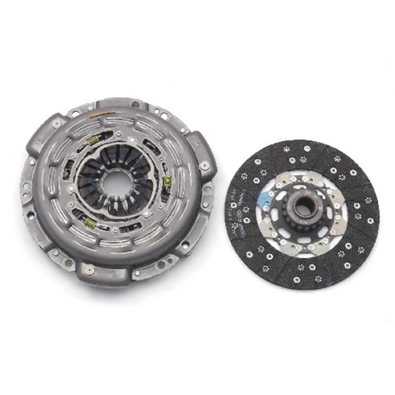

I have been researching where to buy ls7 clutch. All of the sites I have looked at have pictures of the clutch. The problem is that half show a picture of a sprung clutch plate and half show a picture of an unsprung clutch plate. I googled the GM part #
24255748. Just want to make sure I get a real GM ls7 clutch. Anyone know which should it be.

I've heard it's a reboxed LUK branded clutch, which work well amyways.

This is the kit I used last year (w/ ram billet aluminum flywheel option). I can tell you the clutch disk does not look like the one in this picture now - so I'm guessing they have upgraded or changed the part. My disk looks like the photo on the right you posted above.
