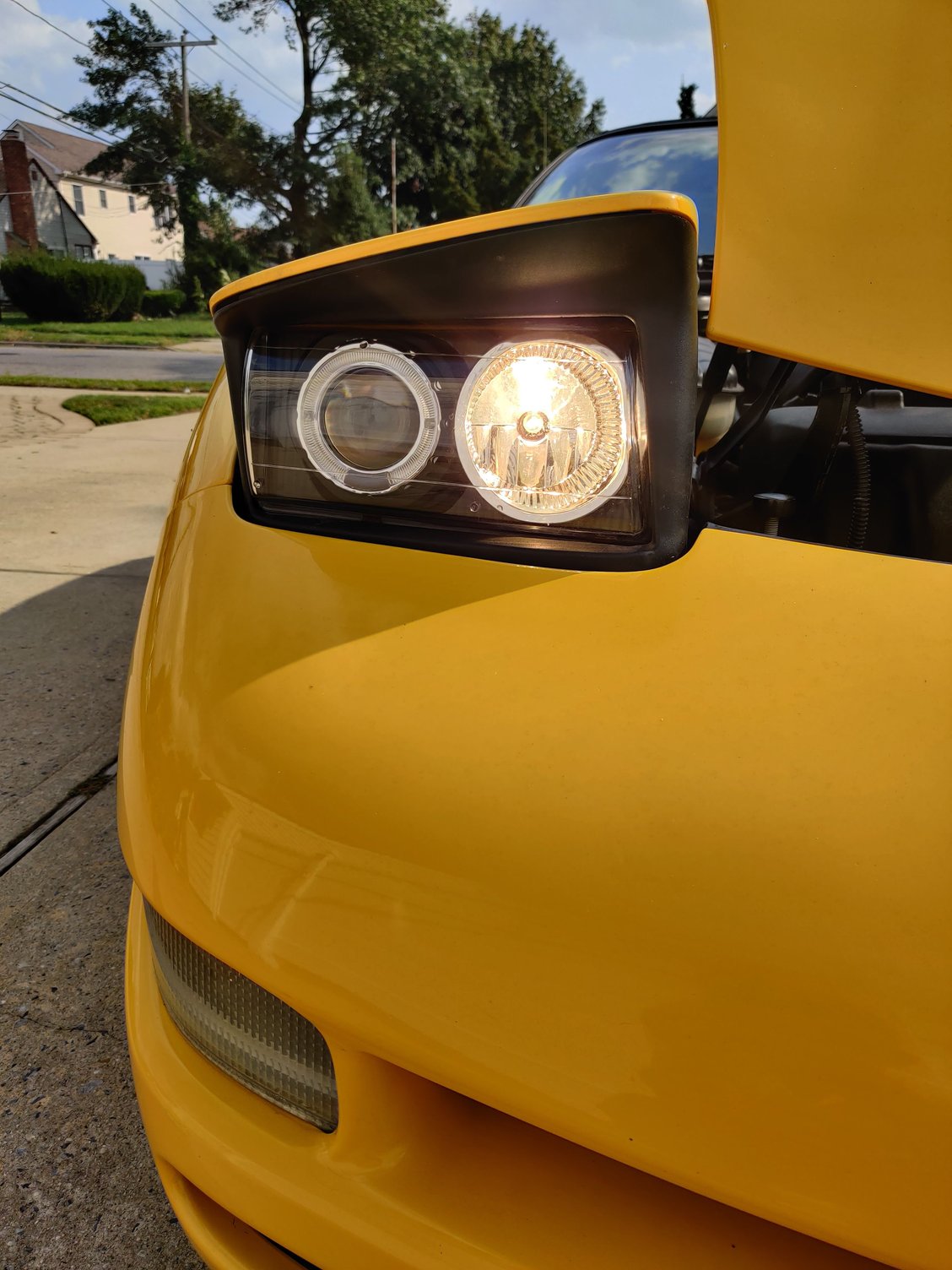

Default I prefer HID.LED fog
For now I run HID 5000K 35 WAT Marimotos Ballest.
I used HID because I have projectors .A more direct clean line. My brites "hi beam" are hologen but LED would work well. It's a reflector and if you look at a hologen beam pattern it reflects into the mirror looking housing.Same as LED.
So your light pattern is spread hi beam tens to light up everything and blind everyone.
At sunset with blackout was defeating the purpose.
See the reflection inside. Hologen and an LED bulb will work fine
Removed the black out and returned to clear.
