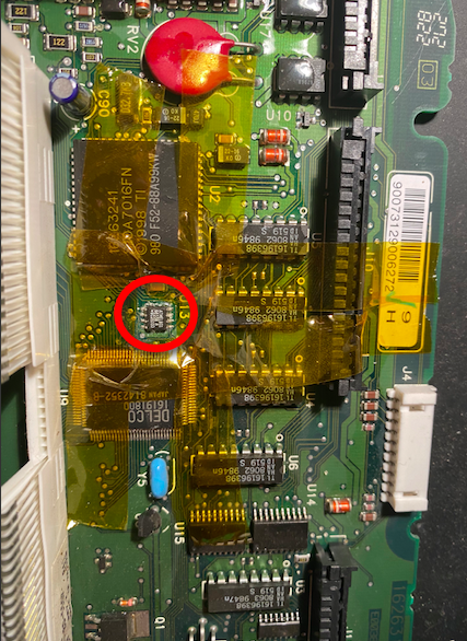

If you buy a used cluster you can try to swap this card from your old cluster into the used one you havejust bought .
This chip is contain the milage of your car .
Easiest way is to swap cards with the milage chip or secondly desolder this chip and solder it onto the circuit card in used cluster you have bought
