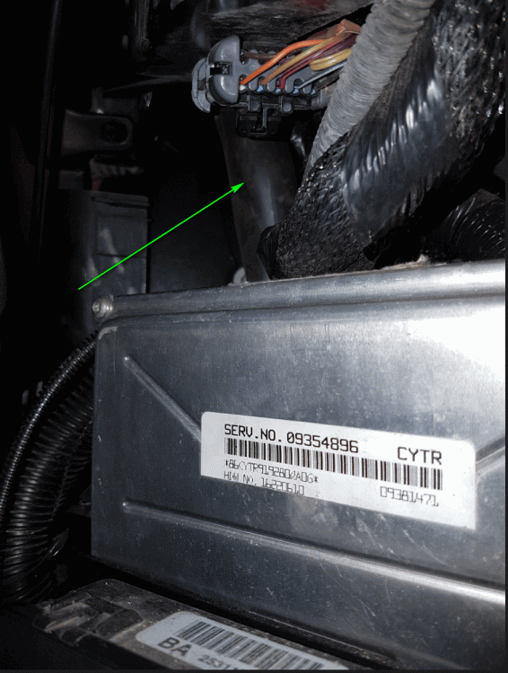

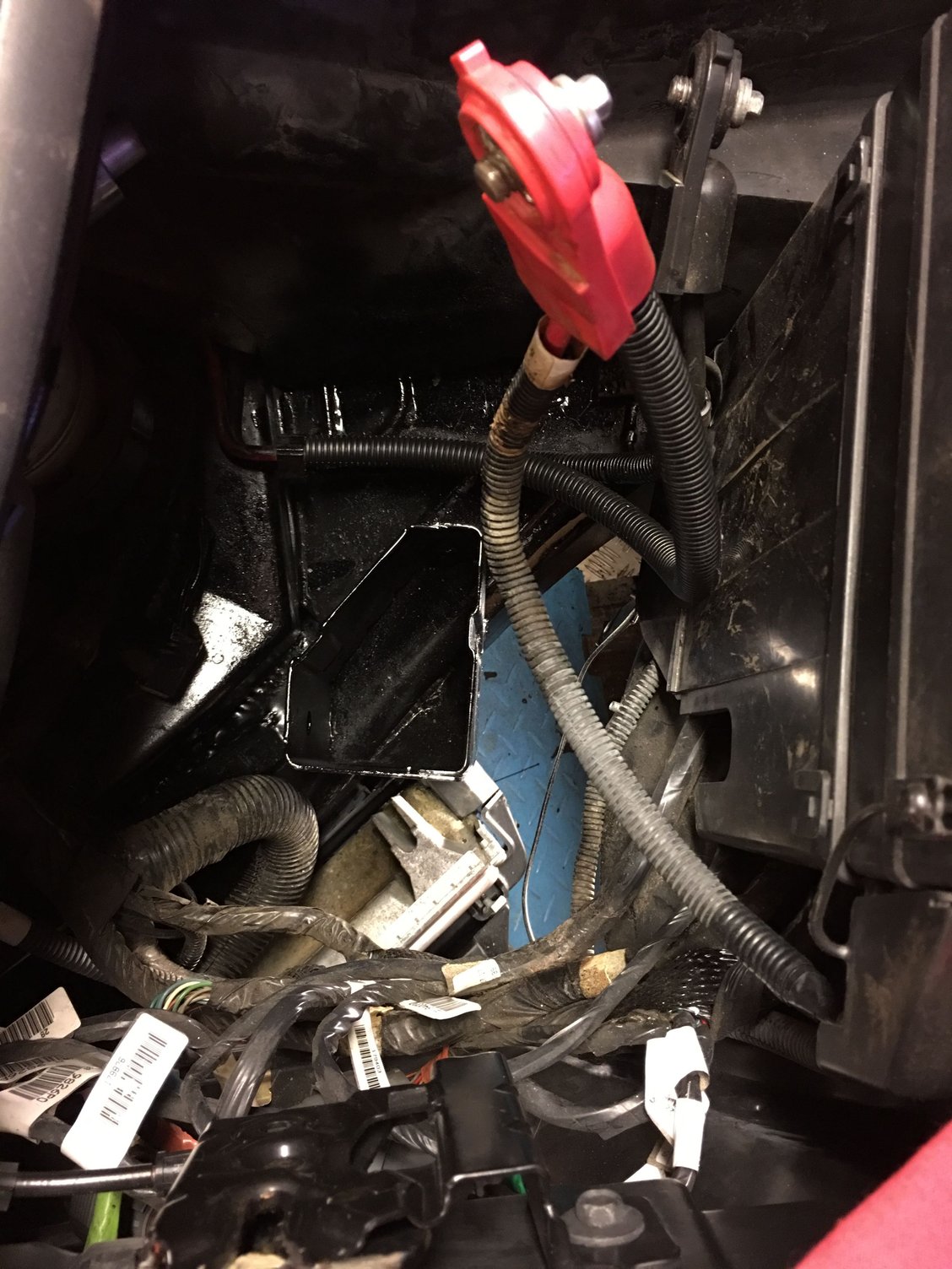

oelarse's Avatar
oelarse
Joined: Jul 2011
Posts: 996
Likes: 306
From: Southern Norway , Europe
On passenger side the green arrow is pointing at the udder behind the PCM .
If you remove batterybase (second picture) it should be available.
The third photo show three udders on driver side
