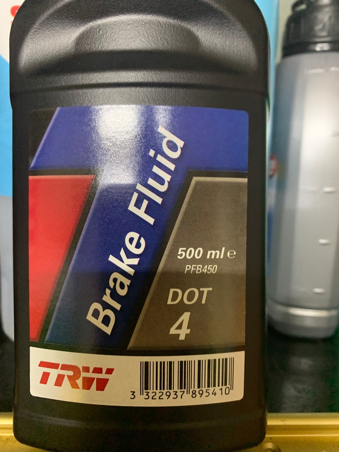

I can't see the oil pressure because the pressure sensor is bad. I am waiting for a new sensor to arrive to install and test it. Problems with the BCM how can I solve them? Is there any test i can do? I made a mistake writing Dexron 4, I wanted to say Dot 4. I understand that the problem of engaging some gears on the C5 with manual gearbox, was solved by changing the clutch oil often or changing some rods from I don't know where, I don't remember.
