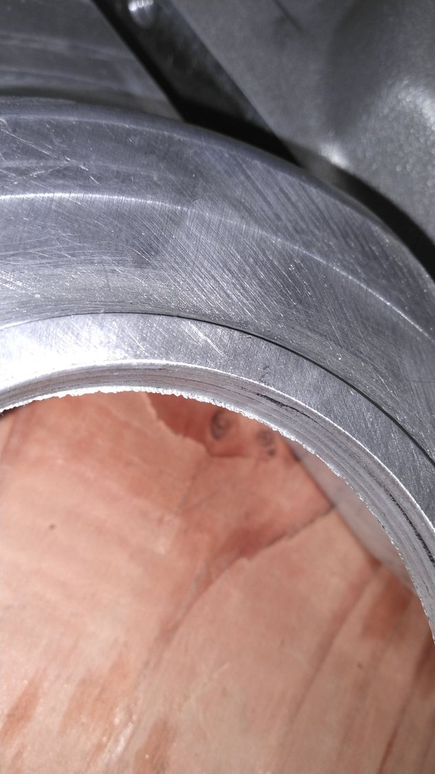

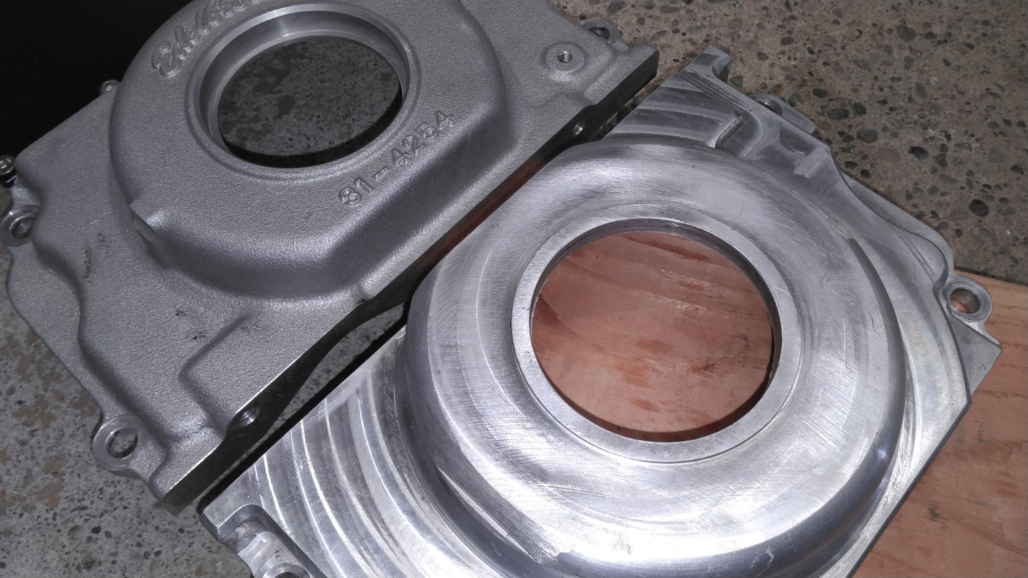

I bought a used qtp 2 piece timing cover for cheap. I knocked out the old seal that was installed in it and just want to get your opinions on what im looking at. Its seems that this cover either wasnt machined with a back flange in the seal area or its been modified. There are jagged edges in there where the flange would be. Anyone who owns one please chime in or anyone who just knows better than i do. I included an edlebrock two piece in the photo for comparison. Could i install this?
Thanks.

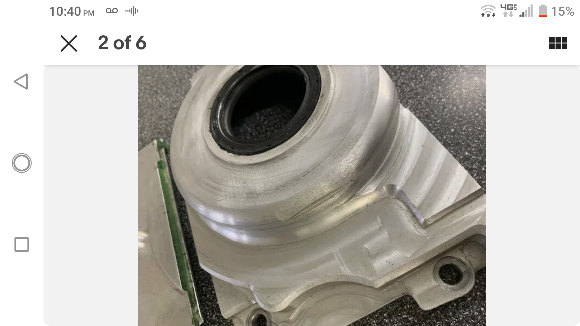

Here are some pictures that the seller had posted. The seal was flush on the front and back so im not sure if the flange would fit (???) 🤷‍♂️

Seems odd, but it should work just fine if you drive the seal in until it's flush to the front surface.

thats what i was thinking because it was fairly tough to remove the old one. I just wish i could see some pictures of other qtp covers without the seal installed but there are almost none on google. My only concern is it walking back and falling into the cover by some kind of impossible murphy's law.

Update: well, RJacobs you were right. I tried installing that cover today and it could not be aligned with the centering tool and the oil pan bolts didnt line up. Completely fed up, i just put the factory cover back on. The dissasmbly of the steering and balancer wasnt that bad so ill just do it again when i do a cam/heads.
Man, Nothing fits like OEM!
