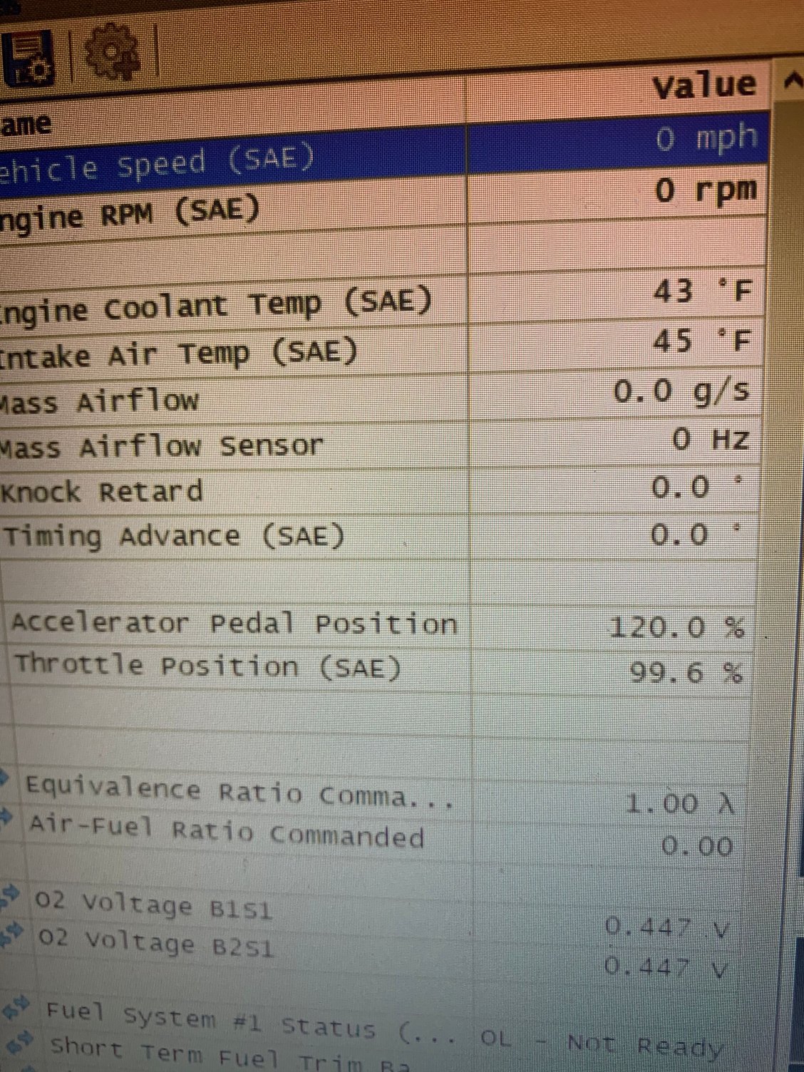

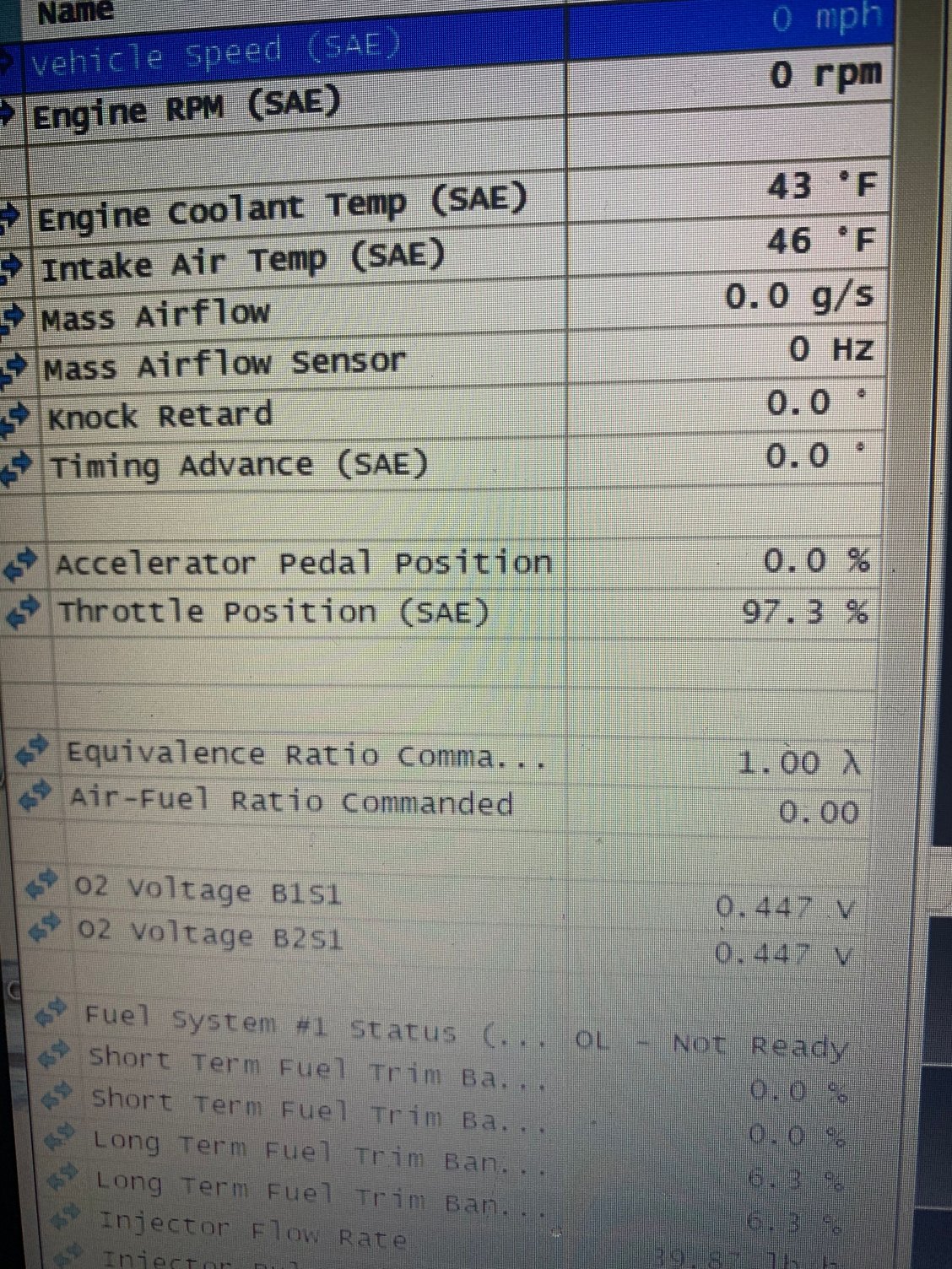

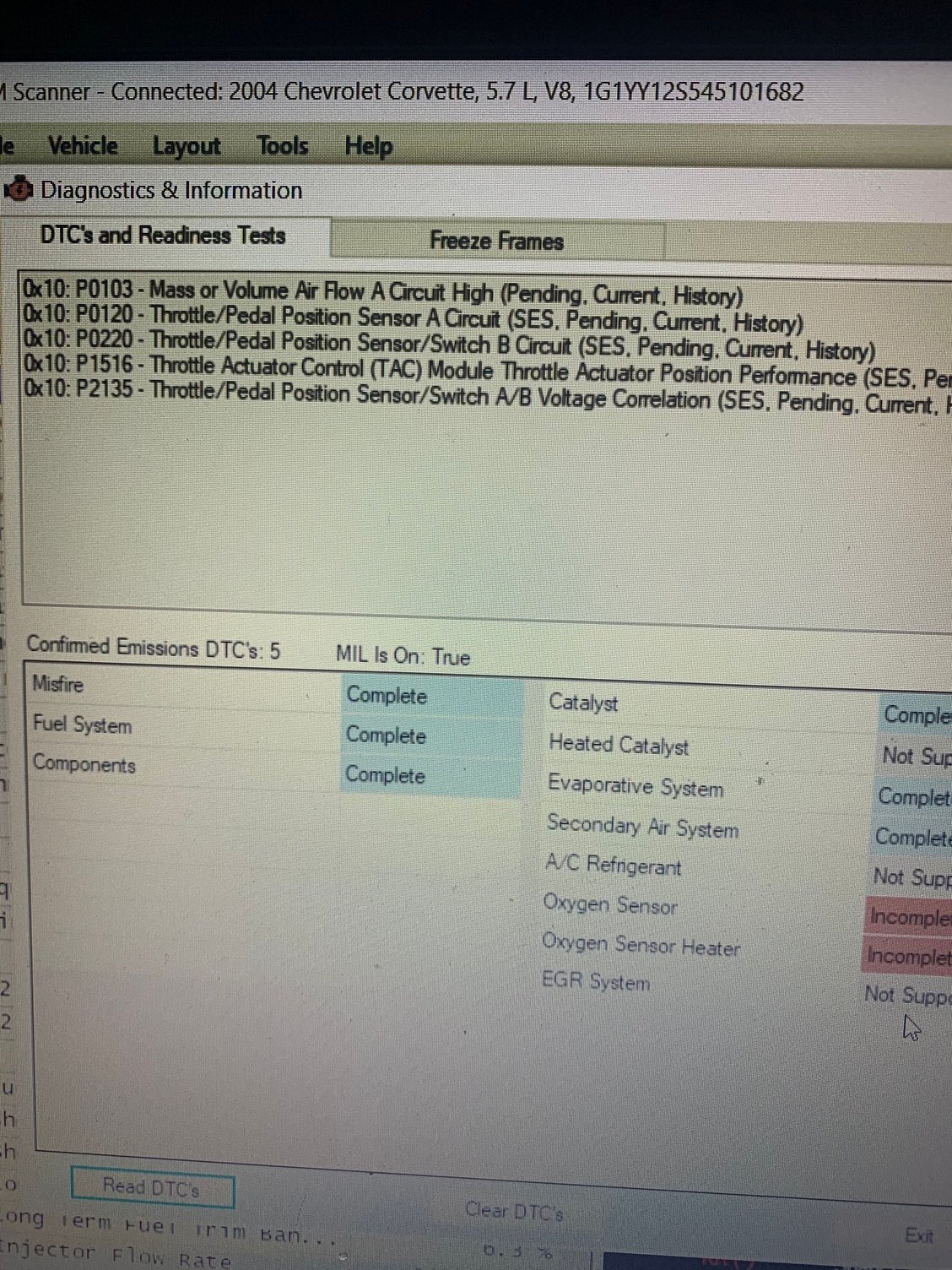

Originally Posted by CinciZ06
Had a moment to run out and plug it in to see what happens.
GM LS2 TB sits at 19.something percent when it’s energized and the car isn’t idling. It will drop down to 6-7% open when the car is started and idling
I installed the knock off LS2 silverblade and this was the result.
The TB would flicker as it ran through its diagnostic process and then fault, showing 99% open and throwing codes.
Maybe be the same internals as the Soler Performance LS2 TB that won’t work with a C5’s OS?
So I’m super psyched about my $150 paperweight. Guess I’ll throw it on EBay, listed appropriately of course.
I see, so same problem then. My stock LS6 TB value was ~15.3% with key on, engine off and no trouble codes. With the knockoff TB, that value rose to 78.8% with the key on and engine off. Some kind of programming issue with the aftermarket TBs.

Old Jan 19, 2021 | 11:13 AM
helga203's Avatar
helga203
Joined: Jul 2010
Posts: 6,013
Likes: 726
Originally Posted by C5ZHI
Thanks. I can’t seem to find a silver blade, so I’m leaning towards and LS3 or LS7 TB now. I plan to supercharge my Z06 in the future, being that my competition at work includes a 2015 Mustang 5.0 manual with 4.10 gears and a 2018 SS 1LE Camaro with a Whipple 2.9 on top. Figured ah, just go with 102 everything so there’s room to grow later.
It appears that only OEM GM TBs will actually work out of the box. Are any GM truck TBs any match? Or are they cable driven? When I think LS2 or LS3 I think strictly the C6 Vettes.
how are you adjusting the throttle percentages?
I'm guessing tech 2 or hptuners. Its all programed through the computer
