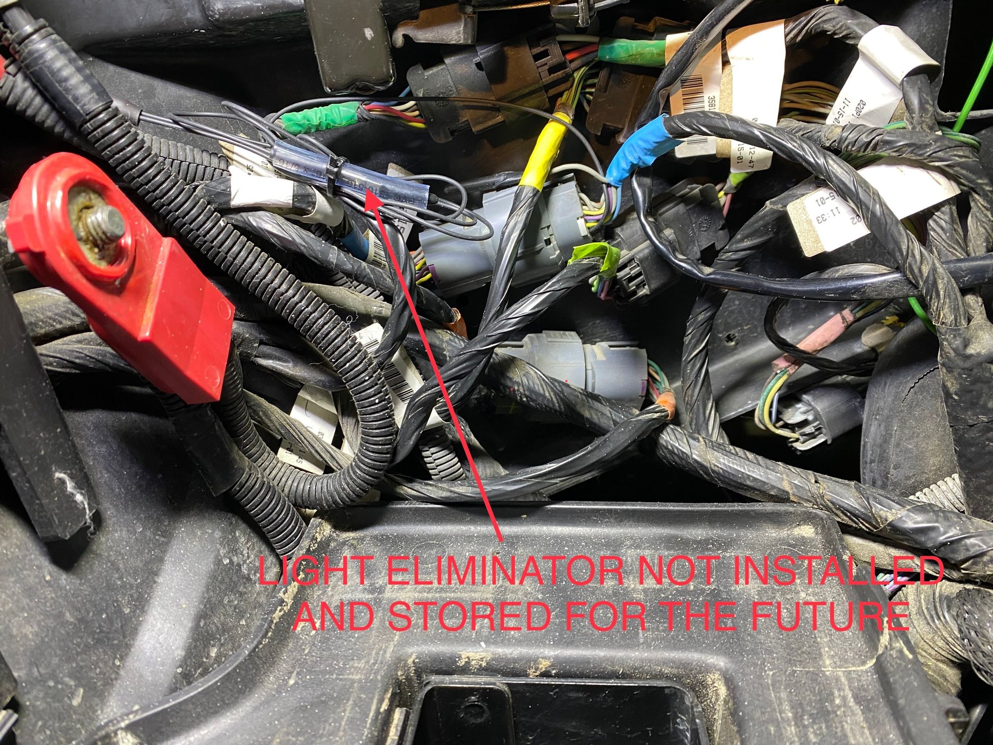

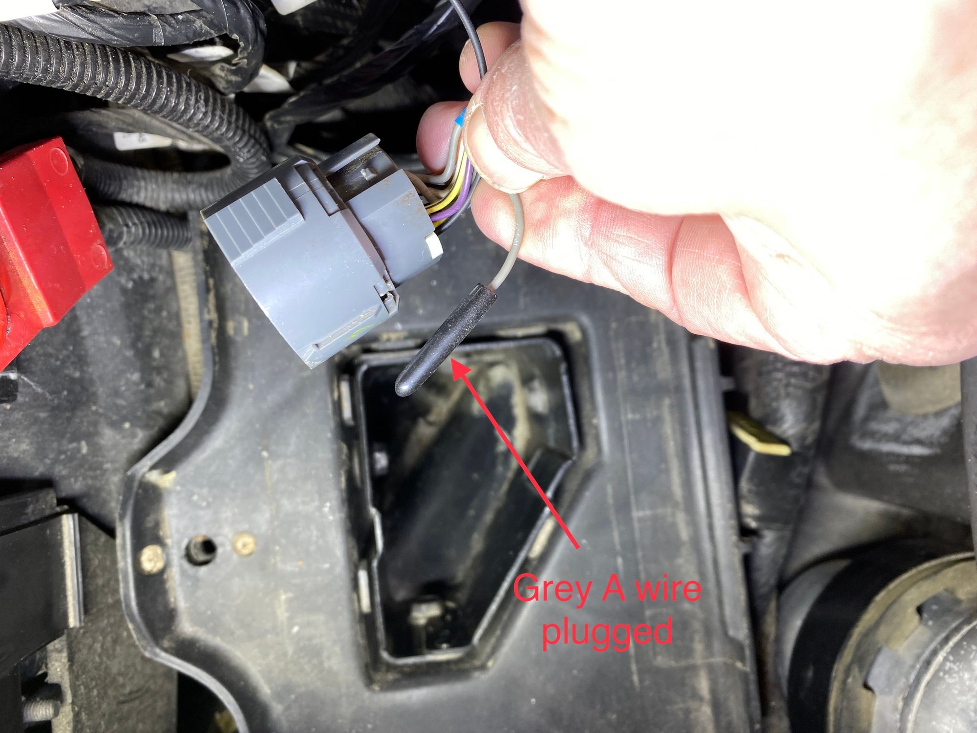

Install blue plastic cap

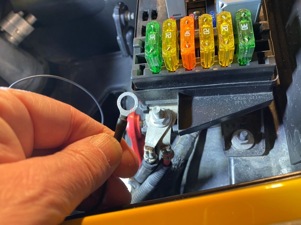

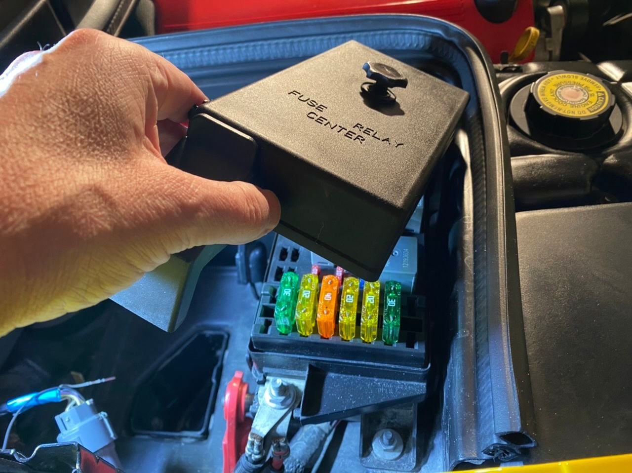

Open fuse box

Installation completed. I did not wanted to install light eliminator now

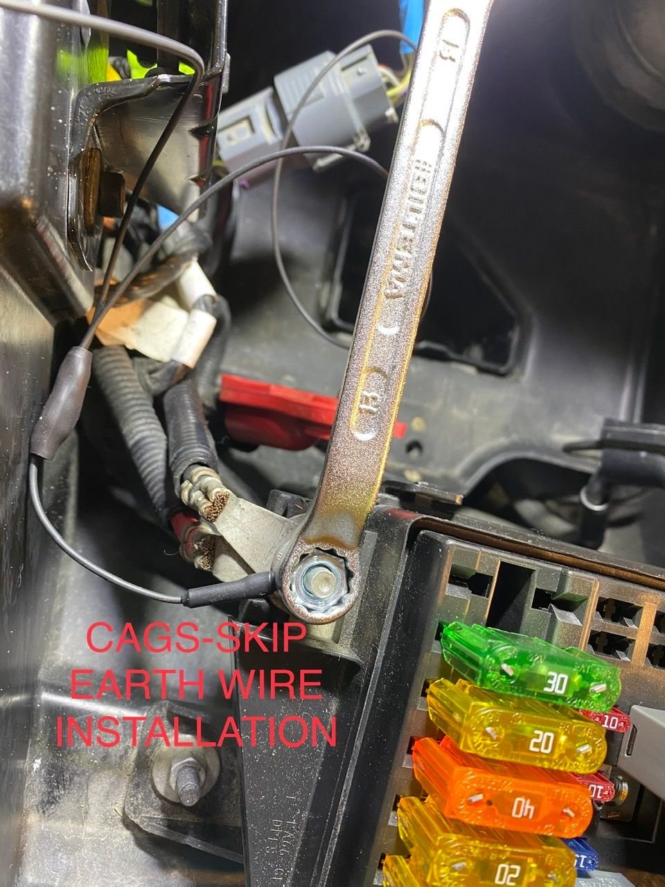

Originally Posted by Lespaul66
I don't think this is earth. It's +12v to the battery.
