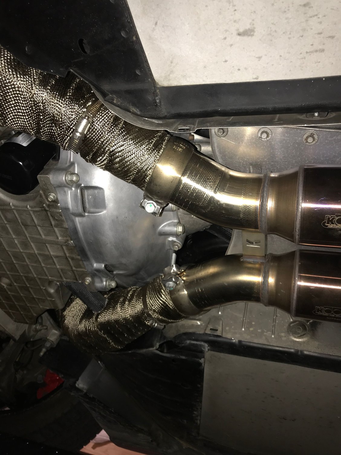

Looking at pictures kooks headers and x-pipe and I see some headers and x-pipe have flanges and others don’t. Question is which is better and can I use headers without flanges with x-pipe has flanges?

I just installed a set of Kooks headers to hook up to my Magnaflow exhaust. You’ll need to use Kooks x-pipe as they use the “ball & socket” (I think that’s what its called) connection to their x-pipe. You’ll also not use the bracket that is attached to the bell housing.
