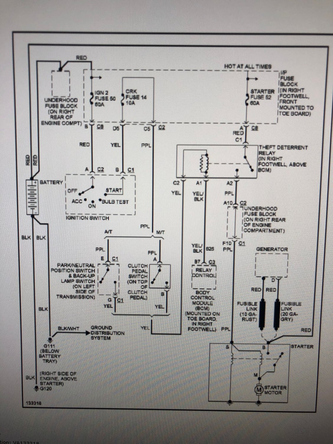

If you have a DVOM and basically know how to check power and grounds in a circuit here is the wiring for an 01 on my Mitchell website...you may be hearing the TDR relay clicking at the passengers footwell where the BCM resides...TDR relay is above the BCM !!...if you need help with the circuit give us a yell..you may need to get underneath the car so be careful !!...you can try jumping the red and purple wires at the TDR relay and see what happens..you can also see if you have 12 volts at the yellow wire at the TDR...if so everything is good upstream to the ignition switch!!..if you really want to know how to understand and diagnose cars watch the ScannerDanner YouTube videos...Paul is a LEGEND and if you can spare $11.00 a month subscribe to his Premium channel... you will learn A LOT !!

As C5 Diag stated the clicking sound in the passenger footwell area is the TDR, that's means that everything upstream is working fine. The TDR could be the cause of the no cranking, you can jumper the red and violet wires at the TDR socket, CAUTION doing this bypasses the requirement for the car to be in park or the clutch depressed. If it cranks replace the TDR, if it still doesn't crank then you have loose cable connections at the starter solenoid, or your starter/solenoid is failing.
