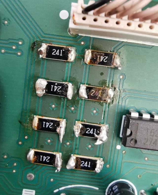

Old Apr 2, 2021 | 04:59 PM
silver50's Avatar
silver50
Joined: Aug 2019
Posts: 289
Likes: 64
From: Edinburgh, Scotland
The ABS fixer info was perfectly helpful but post 6 essentially only repeated what had already been said in post 4 and 5 as the most likely causes for the other issues.
There are very few ‘Vettes here in Scotland and certainly no “ABS fixer” but a guy I’ve met with a 2004 C5 just opened his HVAC and soldered it no problem. It had been done previously in actual fact so has survived two non-expert repairs. See picture! It’s back working despite not looking very pretty. Doesn’t look like a particularly difficult task but the OP could, to be fair, make up his own mind on how to move forward with it.
Old Apr 2, 2021 | 07:59 PM
Chogan835's Avatar
Chogan835
Joined: Jan 2021
Posts: 314
Likes: 61
Abs fixer is a website and company buddy. But yes. Those solders look terrible.
