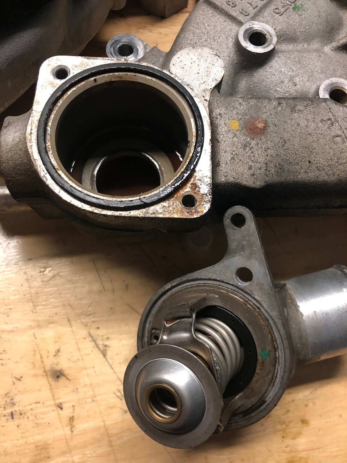

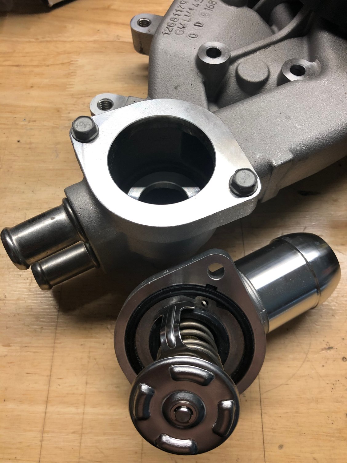

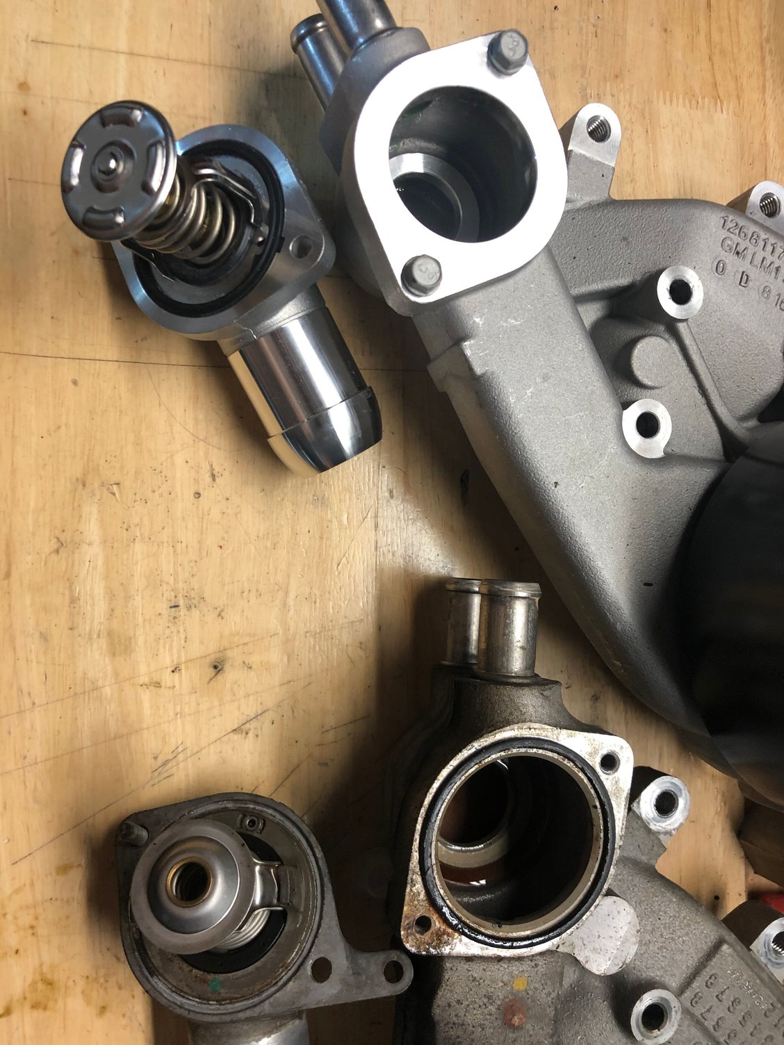

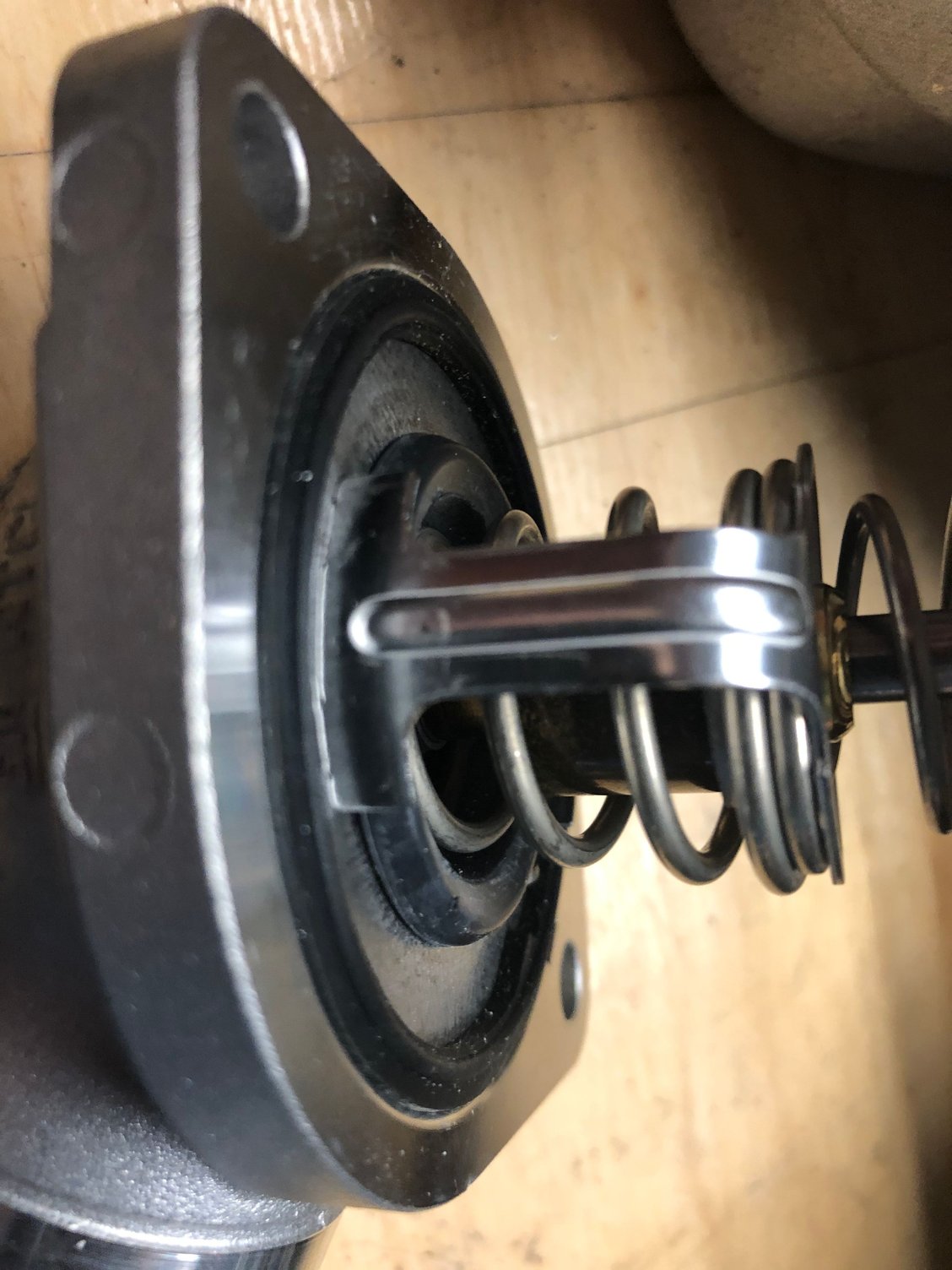

I’ve got a new AC Delco water pump to install. I planned on using the old thermostat. After pulling the thermostat housing off the old pump I found the new pump sis t have the same Oring groove. So I ordered up a new thermostat. Does this thing need an additional gasket or should the seal, seal everything up?

No additional gasket needed. Tightenit down and fill 'er up.

Yep, the o-ring is more then adequate.
