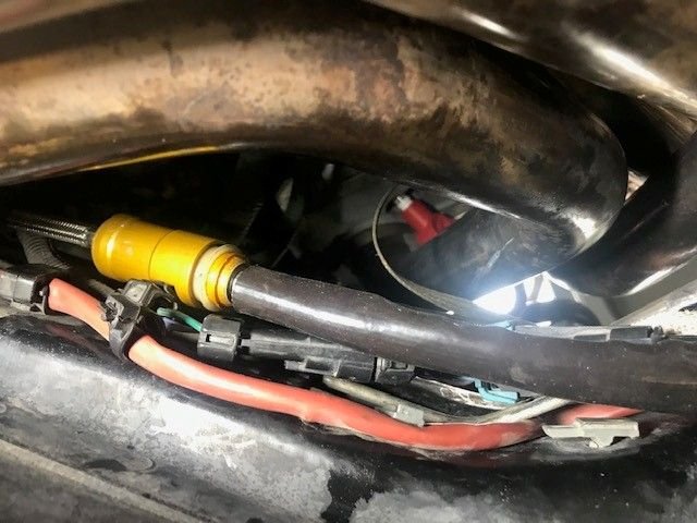

Hi all:
I just spent 2 days installing a TICK Master Cylinder in my 1999 C5 and wanted to let everyone know that the results are fantastic!
I had the common issue with it being difficult to shift into 1st and reverse. Worse yet was that when accelerating hard I had to wait forever to make the 1-2, 2-3, 3-4 shift. The transmission is in very good condition (rebuilt by the ZF Doc in Phoenix < 10,000 miles ago... he also installed a new slave cylinder and remote bleeder and I have been religious about keeping the clutch system flushed) and it has a practically new SPEC stage 2 clutch and light flywheel. Never-the-less I was experiencing these issues recently.
I installed the TICK Tilton clutch master cylinder, adjusted it per the directions and viola, it shifts like "butta" now and easily goes into 1st and reverse and no more waiting to shift when under hard acceleration! So if anyone has been experiencing these issues or simply wishes to improve the shifting of their car I can highly recommend the "TICK fix".
FYI, getting the quick, disconnect to separate is a bit tricky (I suggest buying the longer tool from NAPA). I can offer some suggestions if interested.
Best regards!

Hey I installed this MC a couple months back, I think there's a bit of an air gap around the MC and the hole in the firewall since it mounts different from factory.
Did you happen to notice that? It's been letting in some extra valve train noise ever since.

have the Tick in my 02Z put a rebuild kit in it, and now it won t tighten to the firewall, just a little sloppy in there, the bolts are tight and the holes in the mc are not blind holes, so i can t figure it out.

Hi all: Sorry for the delay in responding. Been busy with a bunch of things.
Multivac: Yes, since the TICK/Tilton MC is different shape than the OEM unit the rubber grommet/donut does not fit well so there is a gap. If that becomes an issue I suppose I could fabricate something or try and seal it with some silicone. I personally haven't noticed a difference in ambient noise coming in from the engine compartment.
Monarch: As I said the difference in my situation was night and day. The shifting issues went away. I think if your tranny, clutch and slave cylinder are in good shape that you would see similar results.
MetalMan2: I too had my tranny rebuilt several years ago but the shifting issues are more related to the inability of the OEM MC to fully disengage the clutch. The TICK solved this problem in my case.
WalleyeJack: The TICK unit is not supposed to come flush against the firewall. It bolts to the metal bracket which positions it properly. If you reattached it properly to the bracket (remember that you must drill a couple of holes in the bracket using the template they supply to affix the TICK to the bracket.and properly reinstalled the bracket and tightened all the nuts (they are a B to get back in) then you should be good.
Let me know if I can ask any other questions.
Best regards!

For the guys having a loose mounting issue the mount holes needs to be drilled out a certain way there’s a bump on the lower middle ish of the bracket that requires drilling out just be careful what size bits your using I think I worked it up to a 7/8 bit mounted greats and flush after

yea. figured it out.. mine had it in, i took it out to put a rebuild kit in it. thought i would just put it back through the firewall and bolt it up.
Not quite that simple, need to take the bracket off on the inside and bolt it on and then install.
