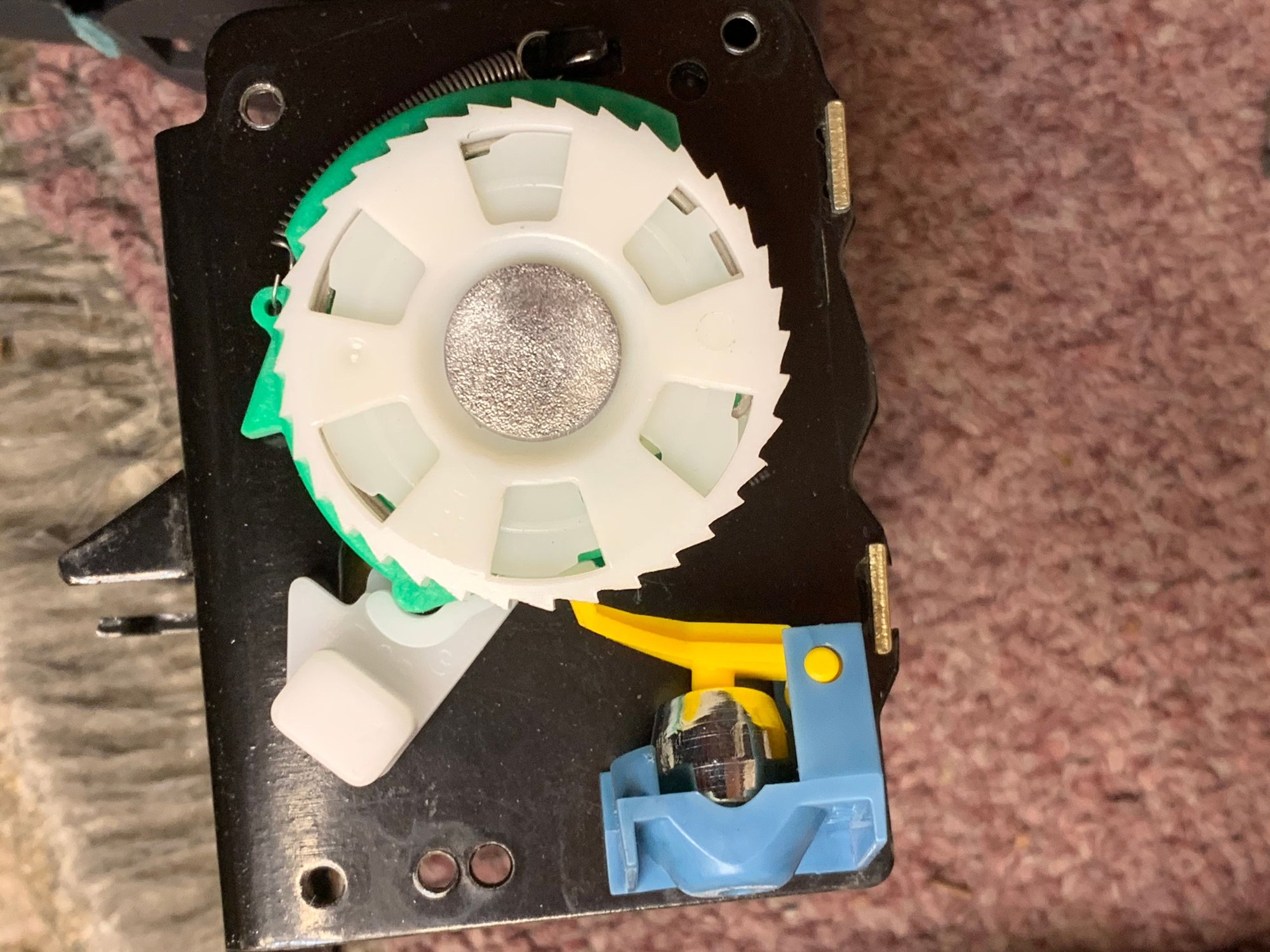

While I can't confirm the C6 belts, the C5 belts have a little silver "keg" barrel that has to be balanced in precisely the right orientation in order to release the belt.
Here's a pic of what I'm talking about when I was troubleshooting my C5 belts.
If your belts are locked and won't extend, any imbalance to the keg will cause the yellow arm to shift up, block & lock up the white cog. The silver "keg" normally will lay perfectly flush which relaxes the yellow arm which allows the white cog to spin which let's the seat belt retract in and out.
Also, if your seat belt "cockspring" has come off, you will also have issues with the belt being able to operate correctly.
I can go I to further details if you need but you may just need to dissect the belts for yourself to ensure that the cockspring hasn't become disconnected from the belt's drivetrain.

these are same as c6. i saw the yellow arm in there and had to lift it, pull the belt out and clamp it.. there must be a happy medium with keg. i was sure i had it centered and relaxed. I m thinking it is just tedious and trial and error work.
thanks for the input.

I think the C6 belts bolt to the C6 seat and not the body of the car like the C5?
Is your seat belt mounting point (where you have your belts mounted to)the same as where they mount in a C6?
I have heard of guys mounting C6 belts to a C5 seat but don't know if the C5 mounting location is the same exact orientation to keep the C6 belt "keg" in a neutral position to stop them from locking up.
