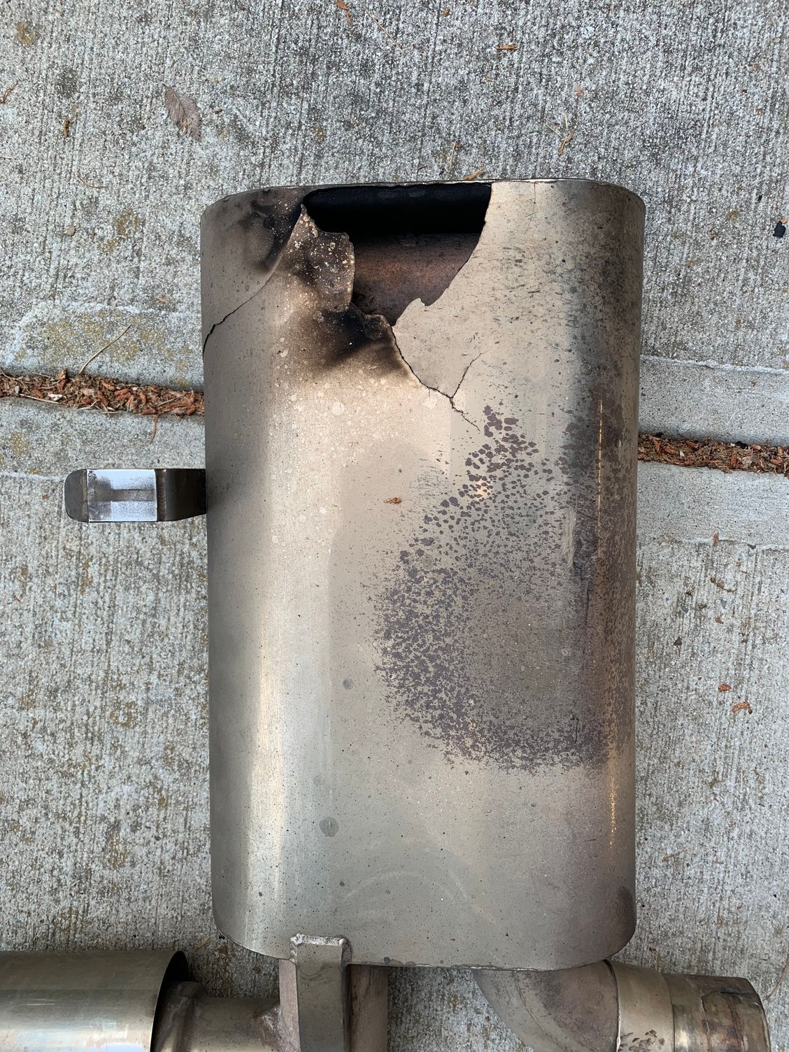

Well, I think I found the problem....
That is top of the driver side exhaust can...right under the little well in the back and there are body vents somewhere close to that. The hole is darn near fist sized so when I'm pushing a ton of exhaust leaning on the car it just blew straight up into the cabin...windows open so body vents would be open too. Wonder if the baffle let loose and blocked exhaust causing it to build pressure and blow out or if when it let loose it just weakened the metal and broke it. Rest of the exhaust is solid, no issues, scoring, anything...
Put a LOT of exhaust into the cabin though...

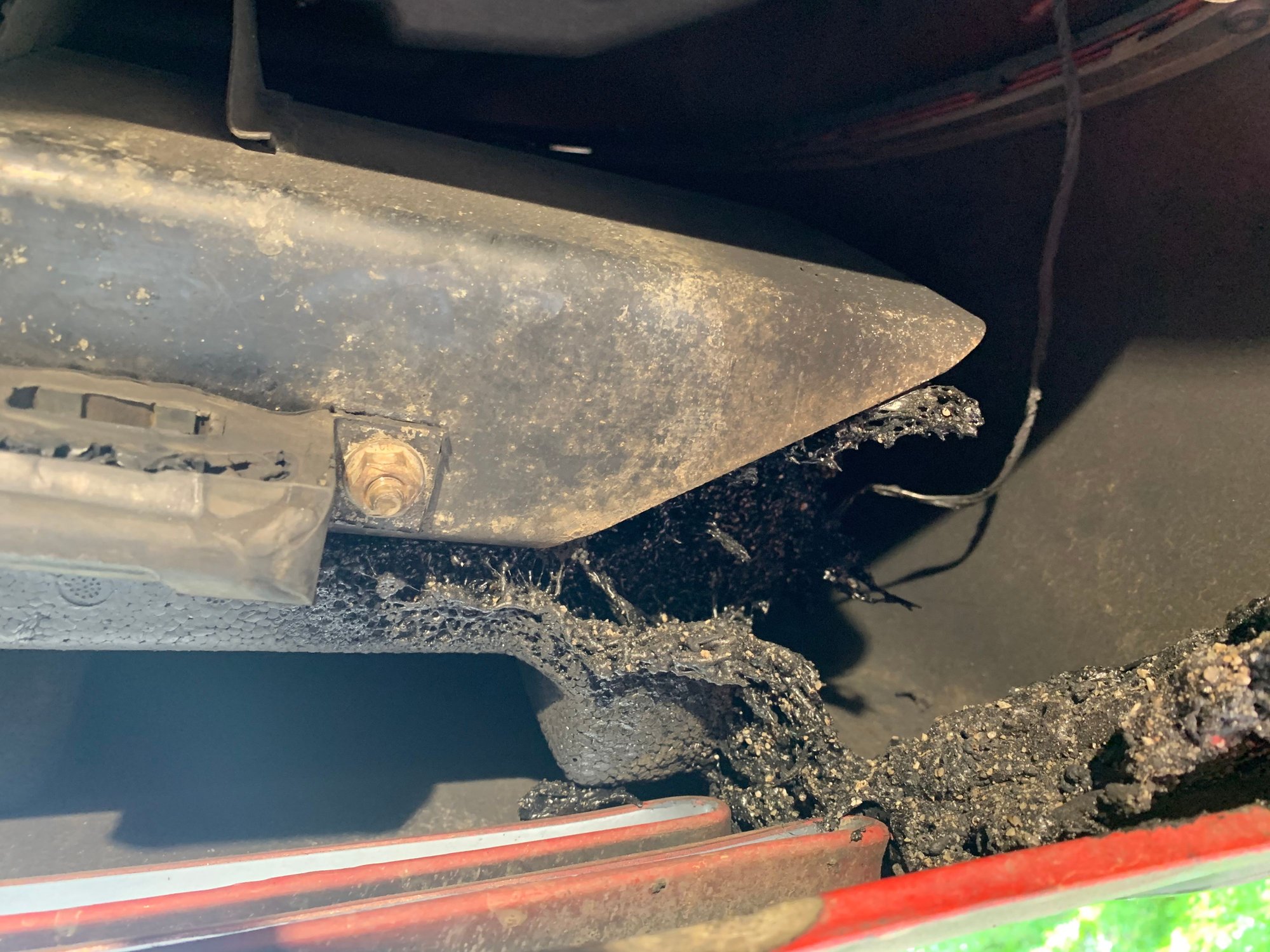

Quick update for all since this was a weird one...been tied up so irritatingly slow to get this resolved, but it's done now. Anyway...here is the culprit of the issue...
And for anyone who doesn't think exhaust gases are hot...here is the fallout of blowing that exhaust for about 6-7 laps...
Yep, that is the 'foam' bumper on the frame...MELTED that stuff like butter!!

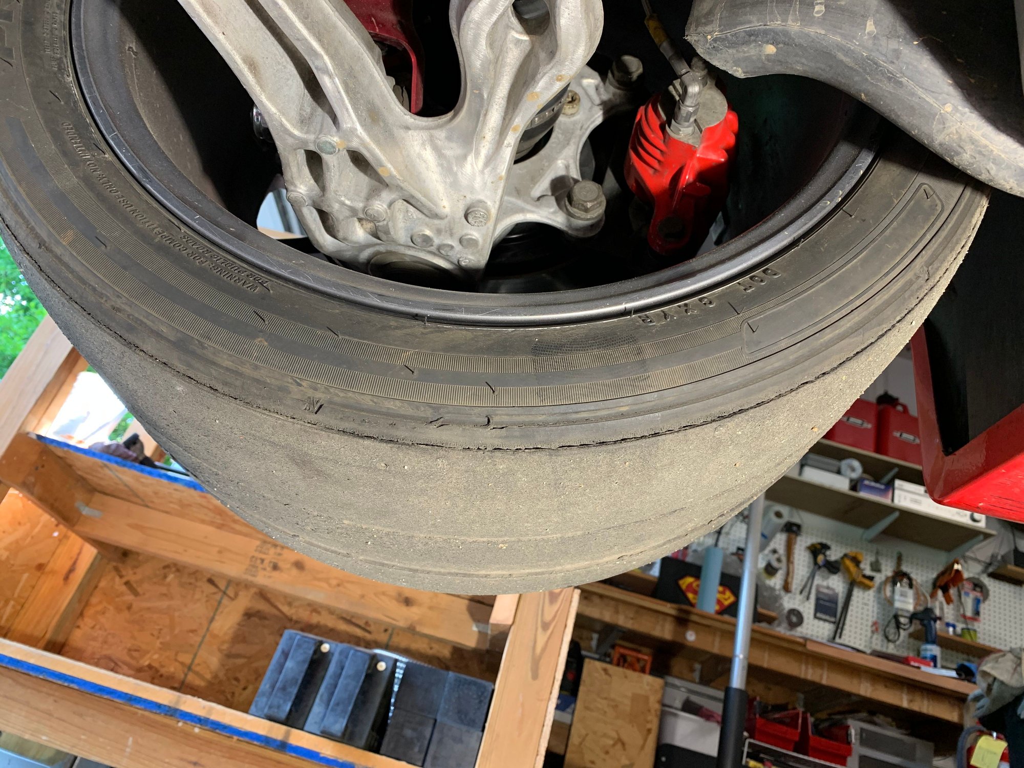

The worst part though, aside from having to shell out for a new exhaust...was I'm pretty sure that extra heat in the area compromised my left rear tire too. Check out the inner edge of the tread...
Overall, too darned expensive of a failure...exhaust, tire(s)...how do you even blow out a muffler like that?!?
Anyway...for your entertainment/consumption, my best advice is if you have something similar - PARK! The secondary damage is what upsets me the most.
