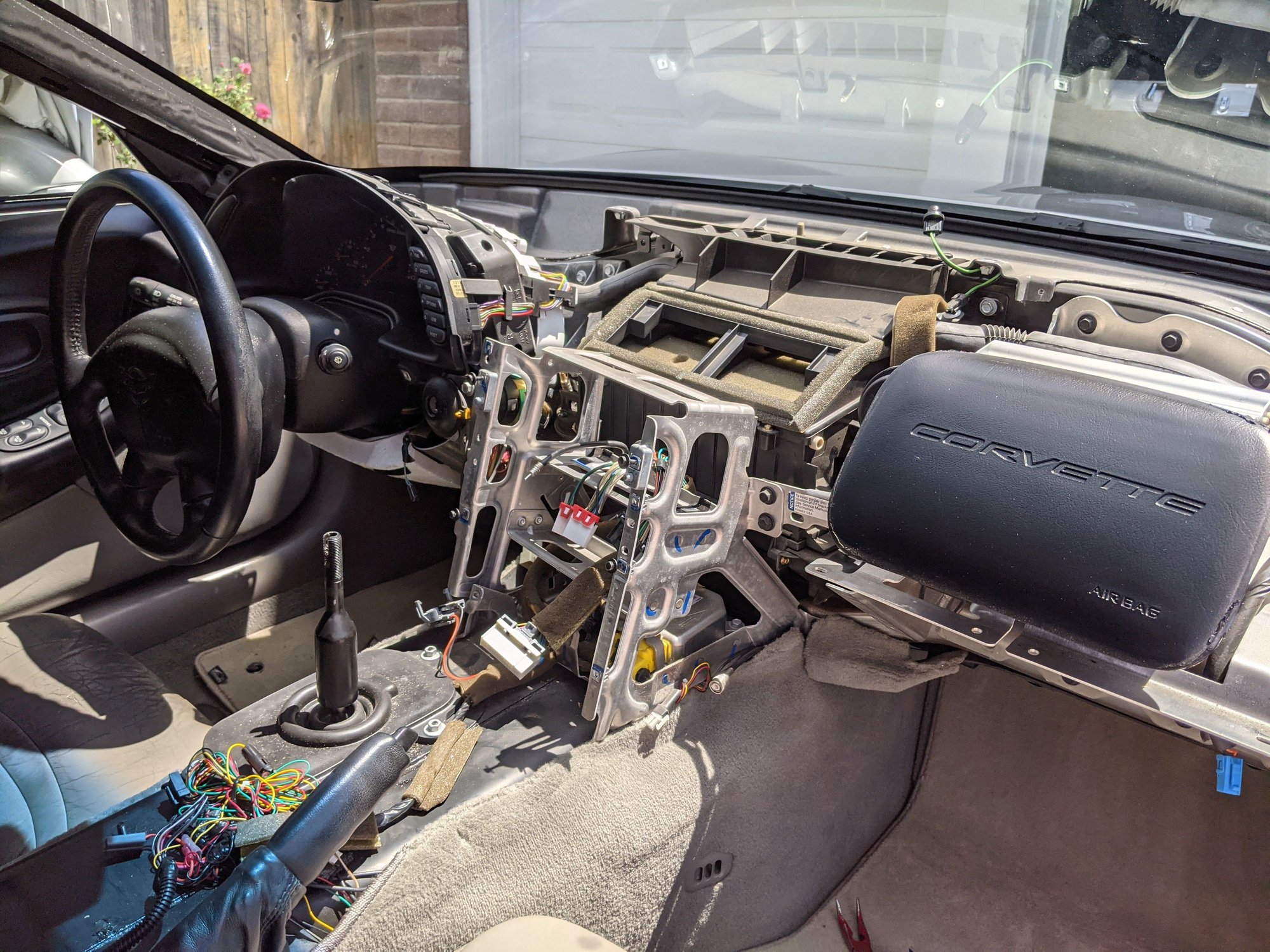

Since it was the passenger side, I decided to remove the dash and replace both units.

It took about 2 hours, but was not too bad. I thought the worst was over. It wasn't!
Actually getting to the actuators is a real pain. Especially the driver's side unit. I had to disconnect some air pipes that run through the area.
They are 23 years old and fragile.. All went well. Probably another 1.5 hours getting both actuators out.

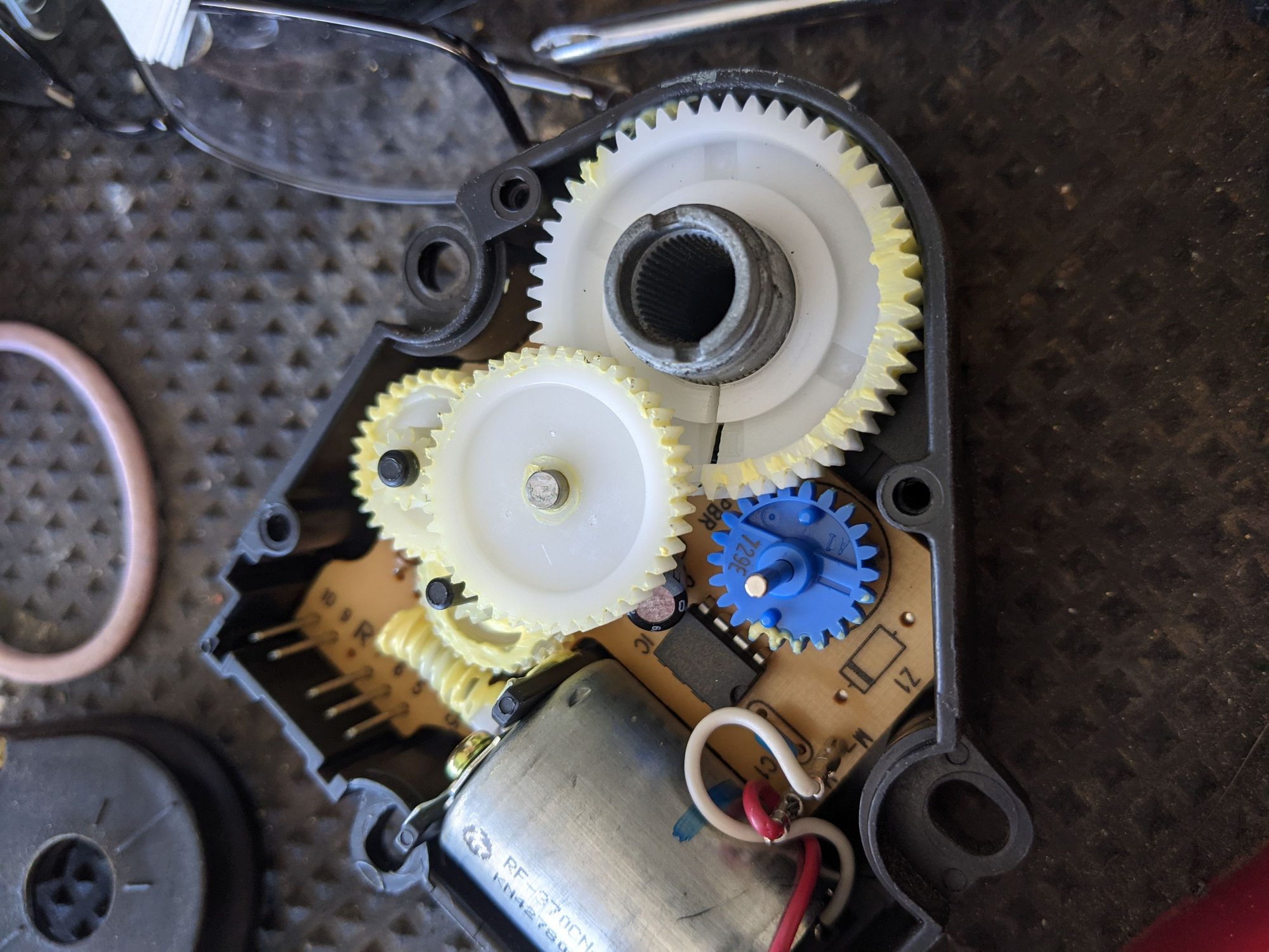

As expected, the passenger side had a cracked gear inside

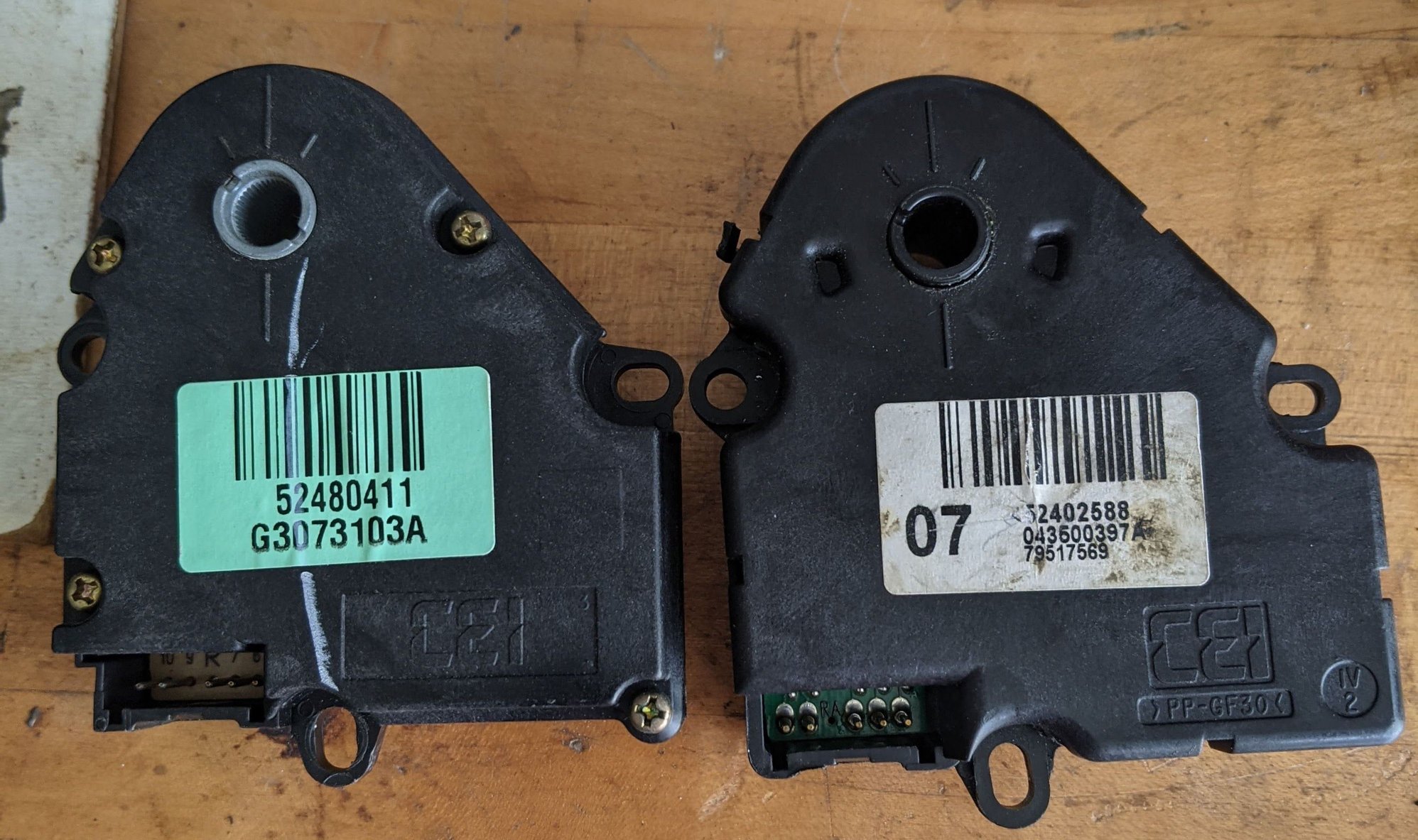

Oddly, the drivers-side actuator was a different type (same MFG, but different design). It was still intact, and probably working fine... But I wasn't going to leave a 23 year old actuator in there!

Thanks Jim. The actuators arrived and I'm about to try to install them. I was wondering how to "align" them.. as I noticed the new units are "parked" in a different position than the old ones.
