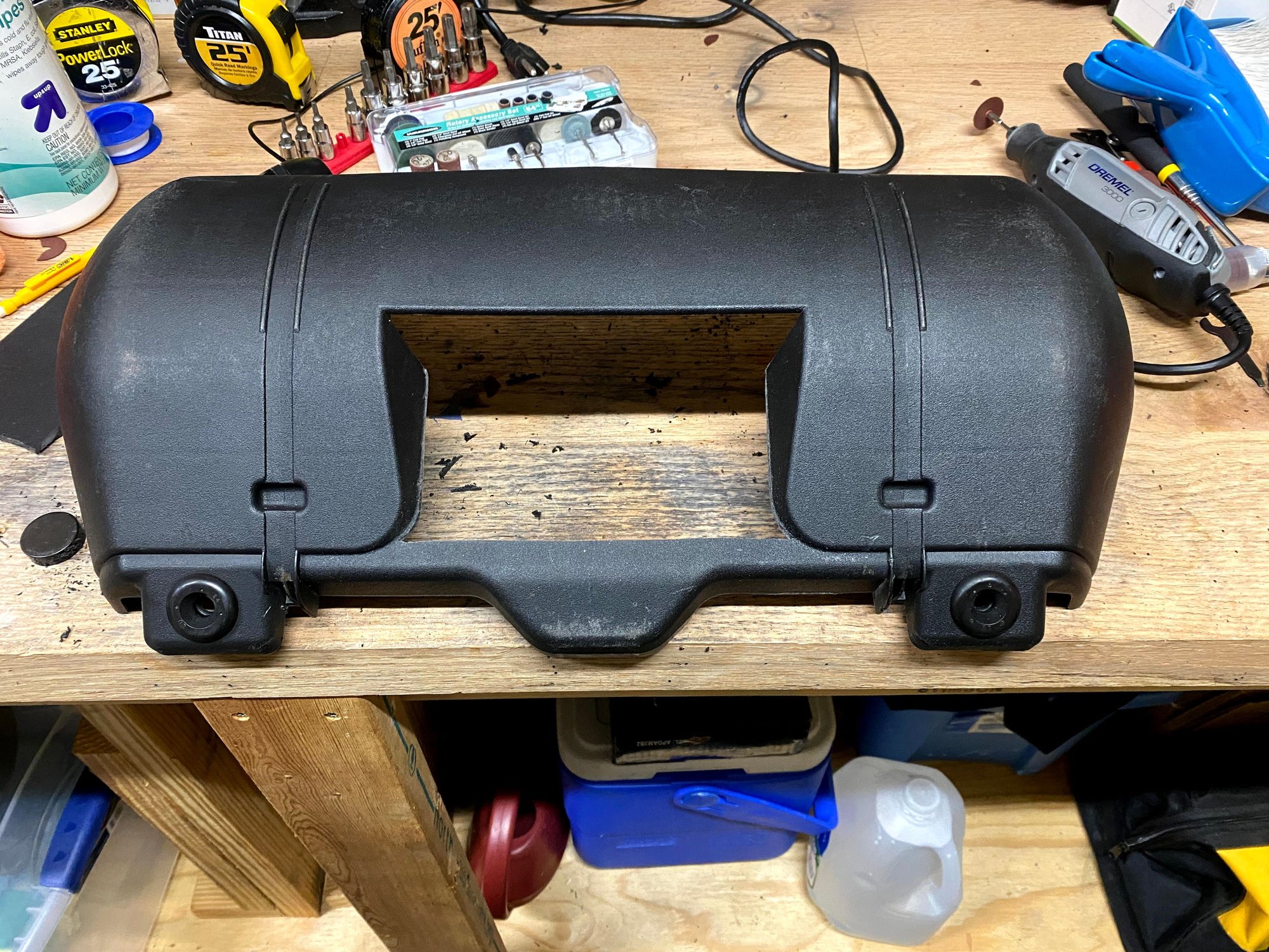

1 3/4 plastic barbed elbow on each side of the stock air box with 1 3/4 duct running to each side of front end fog light area. no engine bay air, just fresh air from front lower. still looks stock with factory air cleaner system. be very very tasteful on how you drill the 97 box for the elbows.
