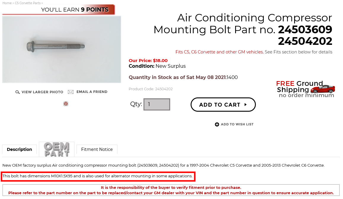

About to attempt to put AC back in my car, the PO deleted it, noticed that the stud appears to be there but the 3 other bolts are not, they seem to also be no longer available by GM.
seems to be that the thread/pitch is m10x1.5 but does anyone know the length? I am sure I Can find some bolts in that thread, but would like to know the length

Looks like it's M10x1.5x95

I was able to find m10x1.5x100 at harbor freight so these should work great !
