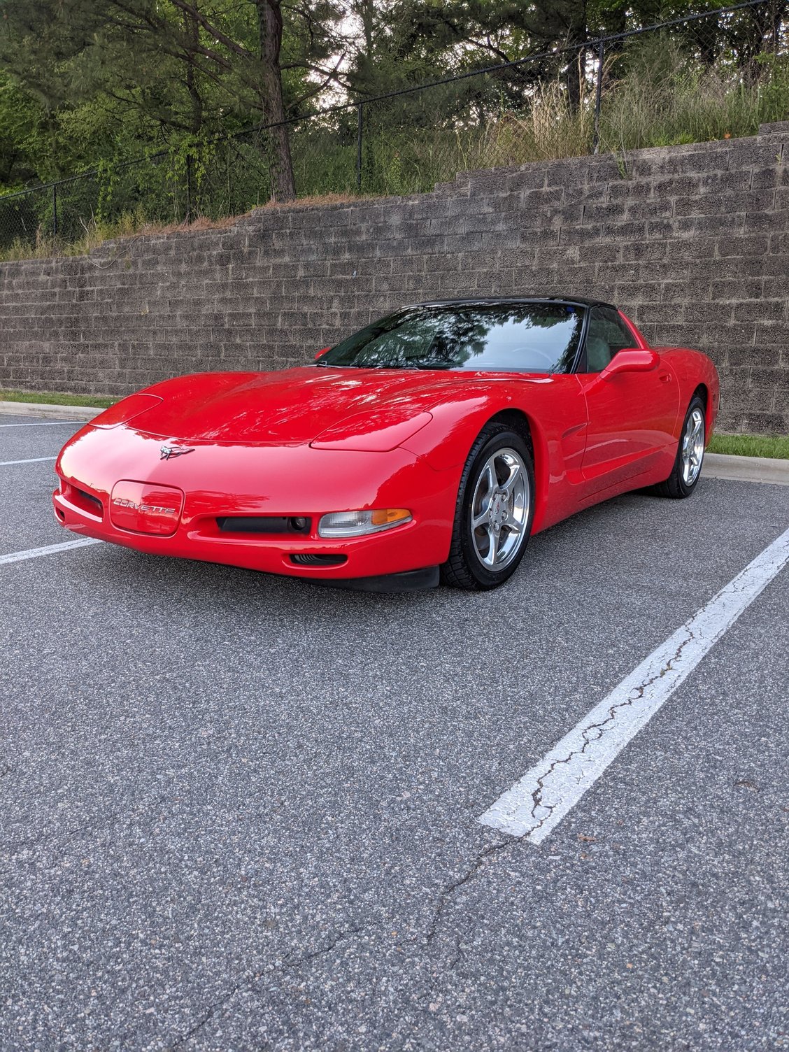

I just bought this red, manual, 2000 c5 Corvette a couple weeks ago. It has only 56k on the odometer. It's been pretty solid, and I love it to death but it's got several minor issues that I'll be working on.

Welcome to the Forums Nice Ride!

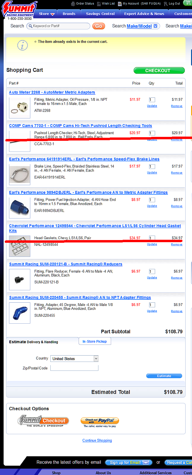

1- O'rilley's has the BWD 4202 sensor that lasts longer than the stock one. You can also relocate it using these parts

Incredible looking car. Welcome. Looks brand new. Have you checked date codes on your tires?

Great looking vette. For #2, you should check to see if the rain ducts (udders) are clean. If water overflows, it can get into the windshield wiper motor. There is a ton of info on this forum so you have come to the right place. Welcome!
