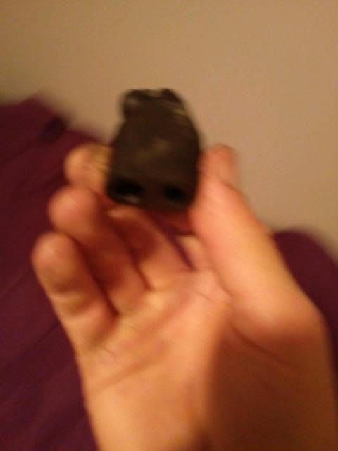

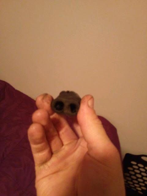

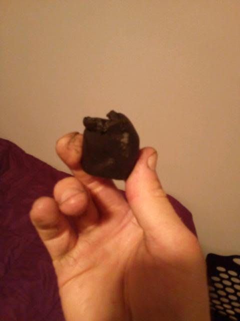

The 3 way joiner behind the intake was rotten when i pulled intake off to remove the air pipe. I did run into this on a 98 z28 back in 2009 and repaired it as i could but its been a long time. You would need a 3/8 brass t with two on one side and one nozzle on the other then run 2" of 3/8" hose to the hard plastic lines that stay pretty solid. I attached pictures of the rotten part can this piece be bought what did you guys do.

Check out the part I mentioned in this thread.
Replacement PCV-manifold Elbow? - CorvetteForum - Chevrolet Corvette Forum Discussion
It has worked great for me for years now. You do have to cut a little bit off of the ends of your hard plastic tubes to get rid of the bump.
