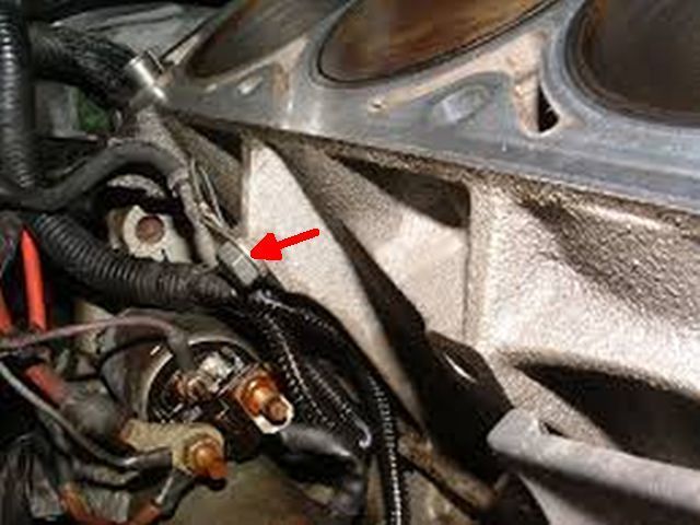

My guess the ground wire circled in blue is not attached

Look at fuse 7 It reads C/LTR (20 amp). Dour your cigarette lighter work?
And this are the grounds by the starter
