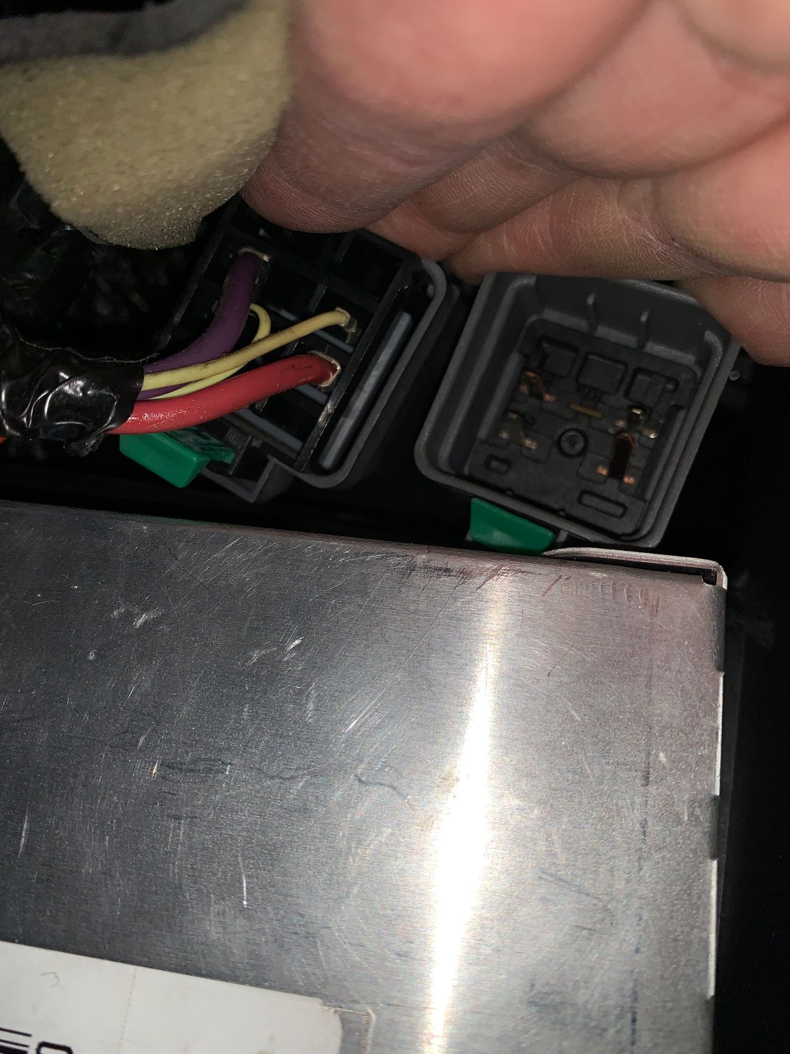

The chip is really a resistor pellet, and if that's the problem with the no start the security light will be flashing instead of being off. The HVAC display being to dim is caused by resistors that were not soldered correctly on the pcb
Next time the car fails to start verify that the TDR located above the BCM in the passenger footwell area is being energized, you should be able to hear it click, it is the relay that sends power to energize the starter. Hope this helps

When you have no start condition your can check if your TDR relay in the passenger footwell above the BCM click . This relay supply 12v to the starter relay .
Also check the connection on your starter terminals .
