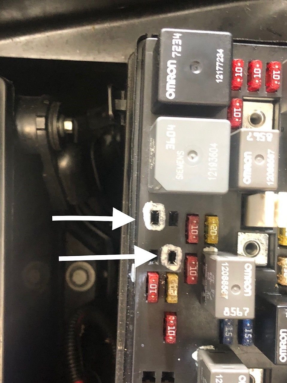

Sorry to hear you're having some issues !!...what do you mean by this...."Fuse is getting power so I switch relays with the horn and that works." ??...so are you saying that when you swap the horn relay into the FP relay everything is OK now ??...just to take the control side of the relay out of the picture can you jump pins 87 and 30 as shown in the picture below with the key ON...the pump will run continuously so try that and see if the car dies again...I'm assuming you are checking your voltages at the pump with your DVOM...if you can somehow jumper the power and ground directly at the pump and it runs that will take a bad pump out of the picture..I'll also include that fuel pump relay video I did on Youtube !!

Yeah so I was just following the wiring schematic but yes, when I swap relays, the horn works so relay is good.
That was my next step, to get a jumper or power probe to the pin on the pump and ground it to see if it stays on. It is my daily so my dad is letting me borrow one of his cars because i don’t want to be left stranded but I tried it last night and fired right up. I also heard the fuel pump priming this time so I knew it was gonna start
