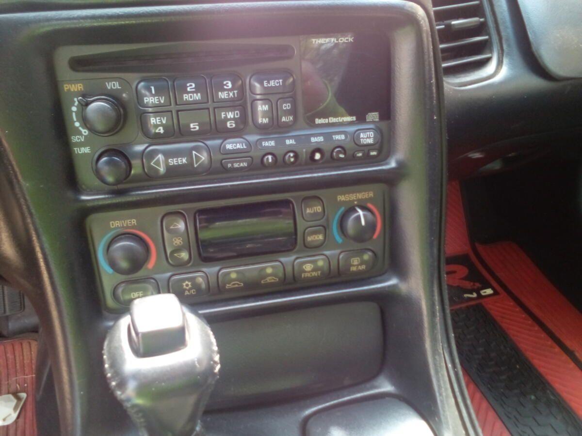

The blower motor is good i unplugged it and supplied 12 volts powered on good. The purple wire is stuck at 13.8 volts and the black wire test open like its not grounding what could the culprit be here? For some reason its not grounding. I told ecklers i had a 1999 automatic car and sent a picture of my head unit they asked i know that but is your orignial control module manual or automatic?

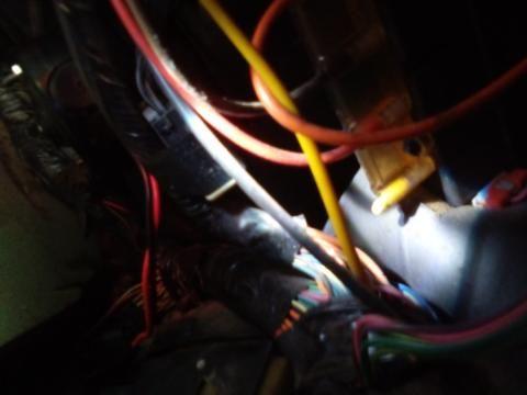

Okay the yellow vacuum tube is broken or looks maybe like a rat had eaten through it. What all does this line function and how hard is it to repair as its right on the edge.? When do the actuator doors kick on should they shift even if the blower motor doesnt kick on? At this point im just trying to get the heater to function as the actuator doors dont shift and blower motor doesnt turn on but the blower motor control module plug has 12 volts all the time and blower motor blows good with 12 volts supplied directly to it.
Old Jun 29, 2021 | 10:37 PM
Justin Raney's Avatar
Justin Raney
Joined: Apr 2021
Posts: 2,191
Likes: 82
okay got the yellow vacuum line back in there snug and still dont hear the actuator doors kick on. May need to access the canister inside the fender to make sure everything is hooked up.
