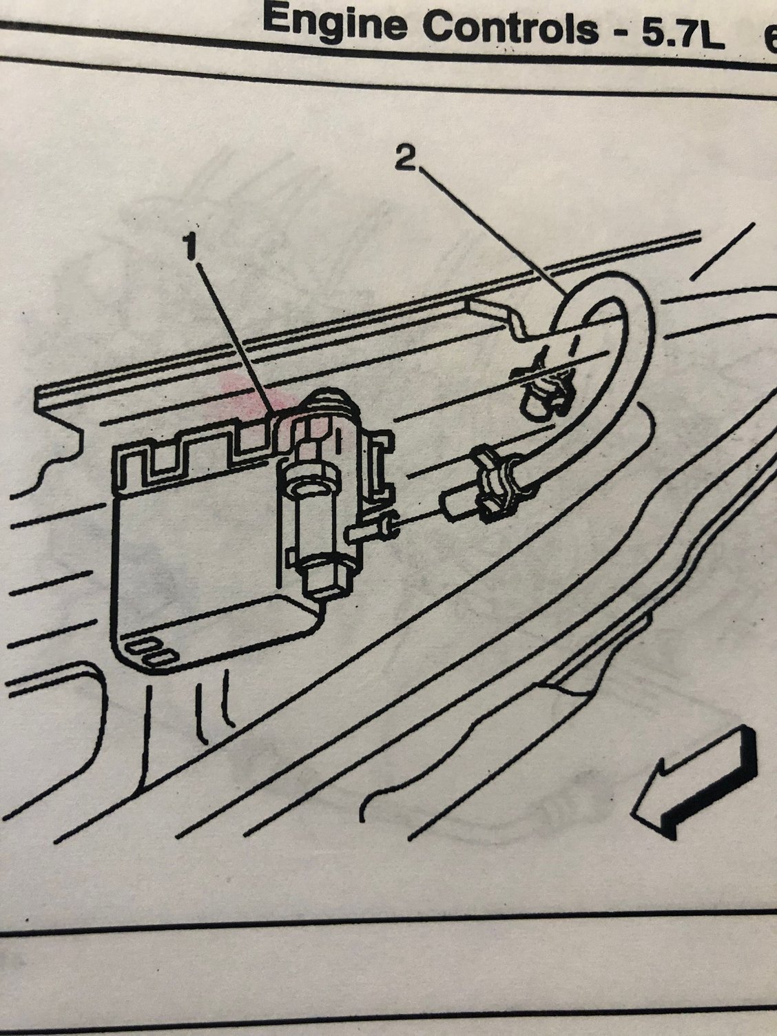

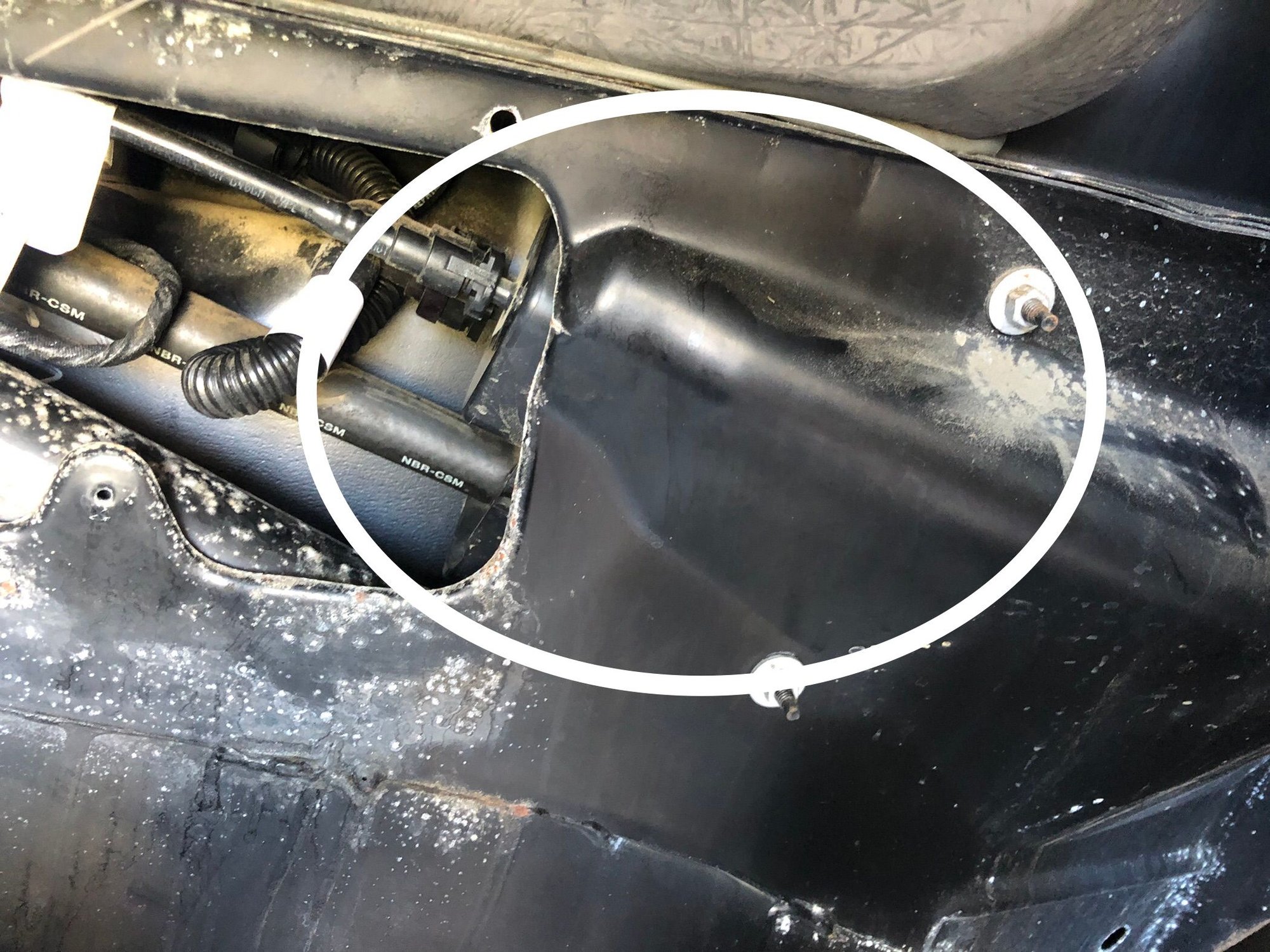

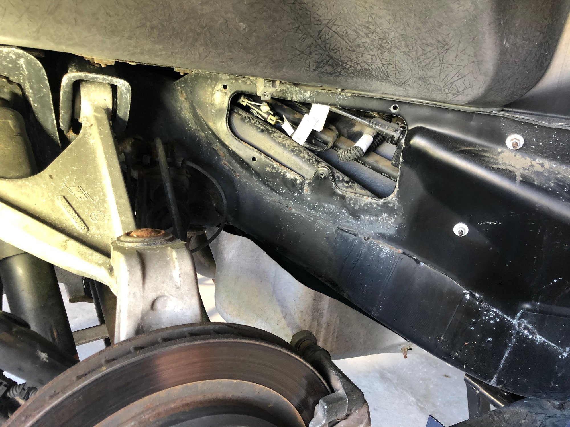

In that area you have the EVAP vent valve (FSM pic) which is located on the inboard side of the right rear frame rail and the EVAP canister which is located behind an access panel in the forward side of the right rear tire area (pictured)…that are the only 2 components located in that area I can think of !!…also when you are filling up your gas tank DON’T overfill it !!…when the gas pump kick off the first time…STOP !!
