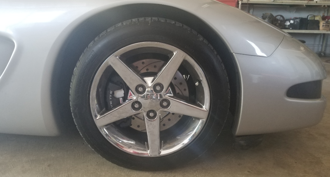

I just put a set of Wilwood front and rear's on my 04, ordered from Summit and it was about 380 shipped. Drilled and Slotted w/the painted rotor hat. Put them on myself in a day, and that included painting calipers and new pads. Not a bad job at all on these C5's. Loving them so far, really cleaned up the wheel area

I bought some Brake Motive pads and rotors, Russel stainless brake lines and flushed it all out with synthetic DOT3. Painted the calipers when I was in there, scrubbed and greased the pins, and gave them a good bedding. The likelihood of me tracking this car is pretty small and I don't live in Colorado anymore where I could tear up the canyons. Braking is definitely improved a bit, but I suspect that is due to the new fluid and stainless lines more than the new pads and rotors. All in all, a well spent $350 in total parts and most of a Saturday talking my time to stay hydrated thanks the Athlete's Beer, Michelob Ultra. This and the brand new Continentals Extreme Contact Sports made a great increase in manners and my confidence in the car.
