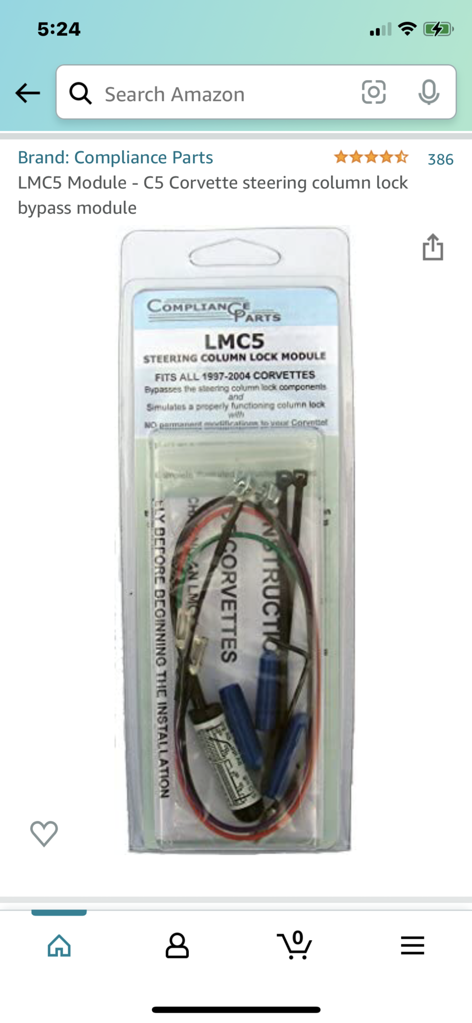

Thank you all, and yes I’m stationed at Mountain Home Airforce base, and I checked my BCM and I already have the LCM5 connection for the service column lock, which is why I’ve been so confused

I had an older LMC5 and if I can remember I would occasionally get the 2 MPH shutoff…if I can remember right…LOL !!….I replaced it in August 2019 and this newer one had the brown wire on it to do that mod !!…like I said with low battery voltage you may see the Service Column Lock message !!…I would replace it and see what happens…does yours have the brown wire ??
