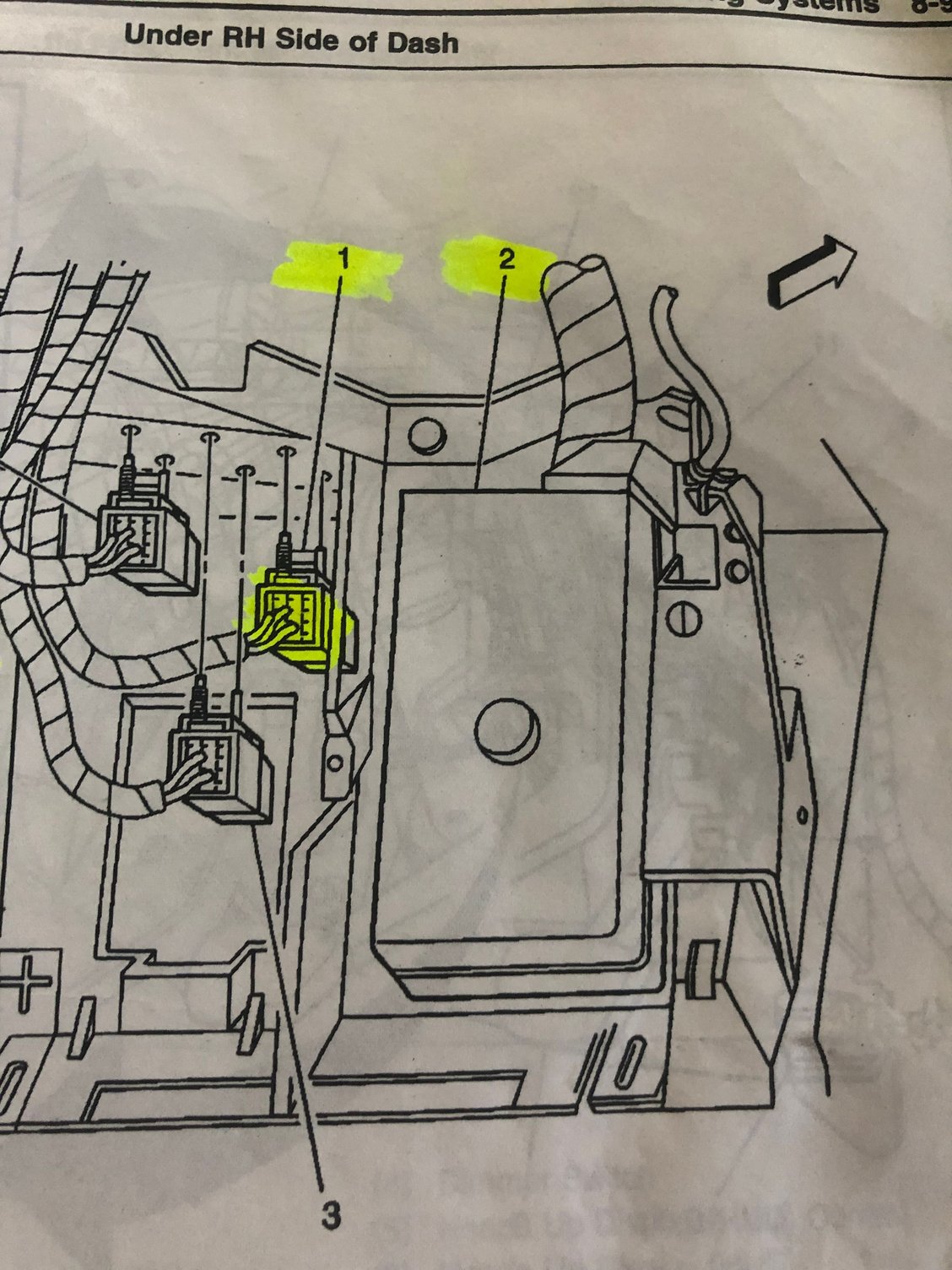

Where is the TDR socket located?

Just to the left of the BCM !!…highlighted #1.

So just to ensure you locate the TDR and its socket, it has four wires, red, violet, yellow, and yellow with a black strip. The red and violet wires are a heavier gauge wire size then the two yellow wires.
