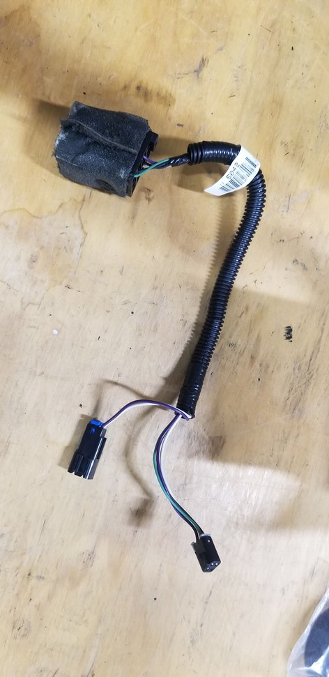

Installed the Tick steering column lock bypass today. Didn't fix my issue. Per the recall years ago the dealer performed 89023816 and harness K 02195-C. Fooled around in the passenger footwell and tried cranking the car again. This time no message. I forgot to unhook my battery tender when I cranked it and didn't get the message. Put the passenger compartment back together, unhooked my battery tender, cranked the car up and the message is back. So I either have a weak battery or a loose connection in the passenger footwell. Does it ever end??
Old Jul 14, 2021 | 05:39 AM
jlturpi's Avatar
jlturpi
Joined: May 2013
Posts: 184
Likes: 22
So my 99 manual transmission car apparently had two additional relays installed under the factory recall. This one was located at the steering column. It's also the one that gets unplugged when installing the steering column lock bypass. What wasn't clear to me from the installation instructions is where the bypass should be plugged in at. In my case there were two options. The incorrect one which I tried first was into the end of the harness in the picture above. The correct location was into the factory harness where this relay was previously plugged in. Maybe I'm not the brightest or maybe this will save others some headaches in the future. I no longer have the service steering column lock message though. Now I need to change the 2mph fuel cutout in my tune in the event this problem comes back in the future.
