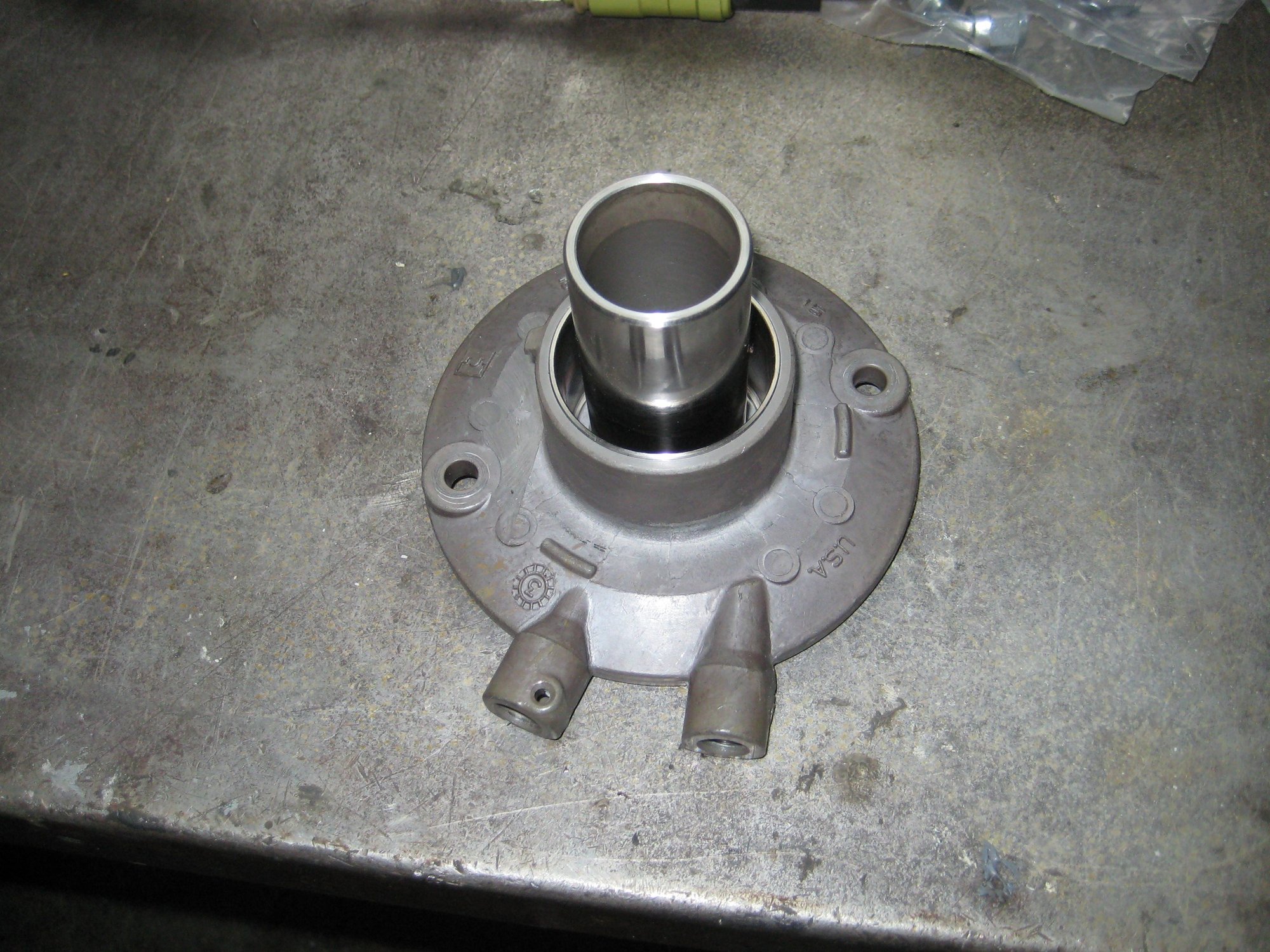

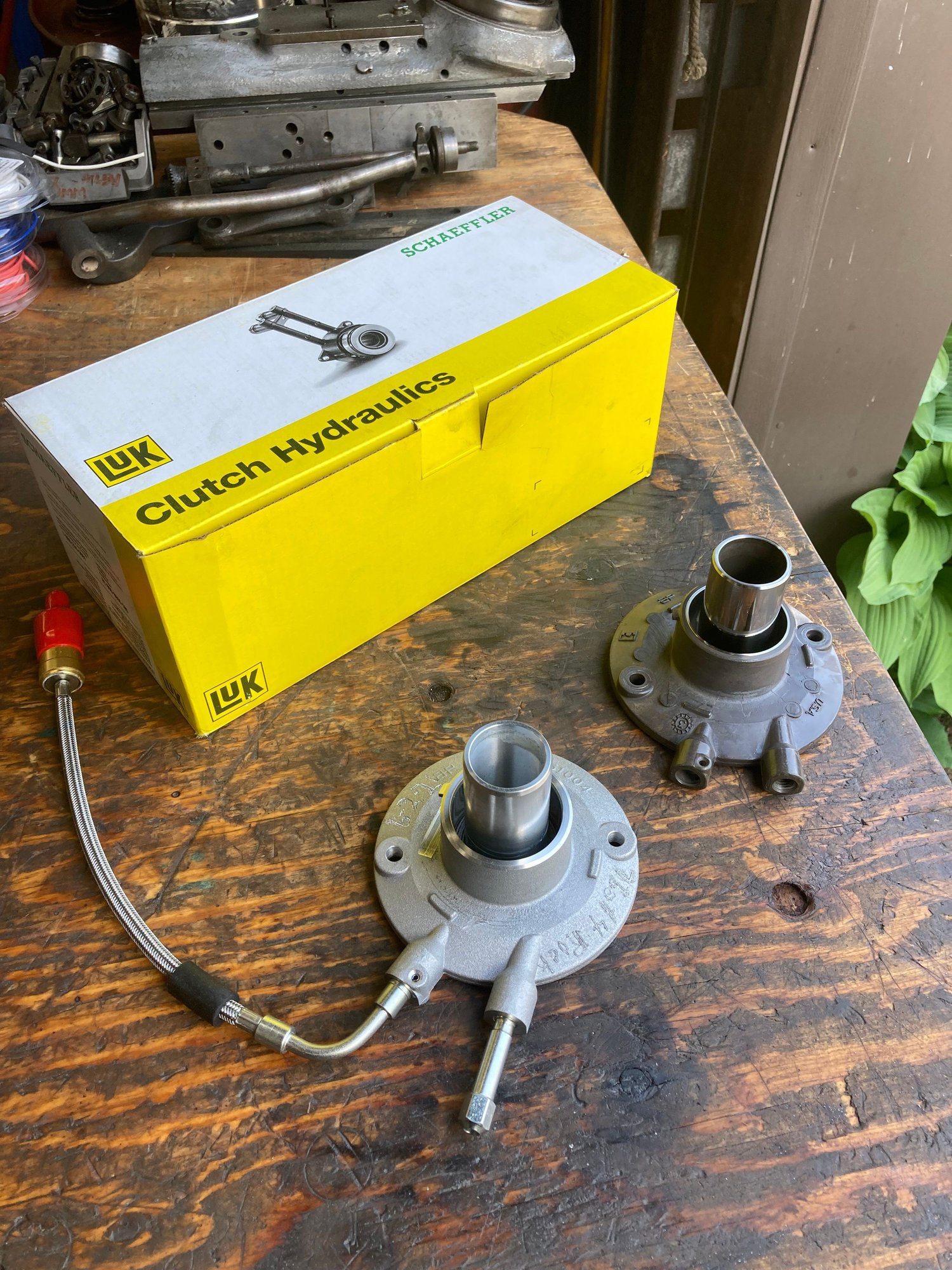

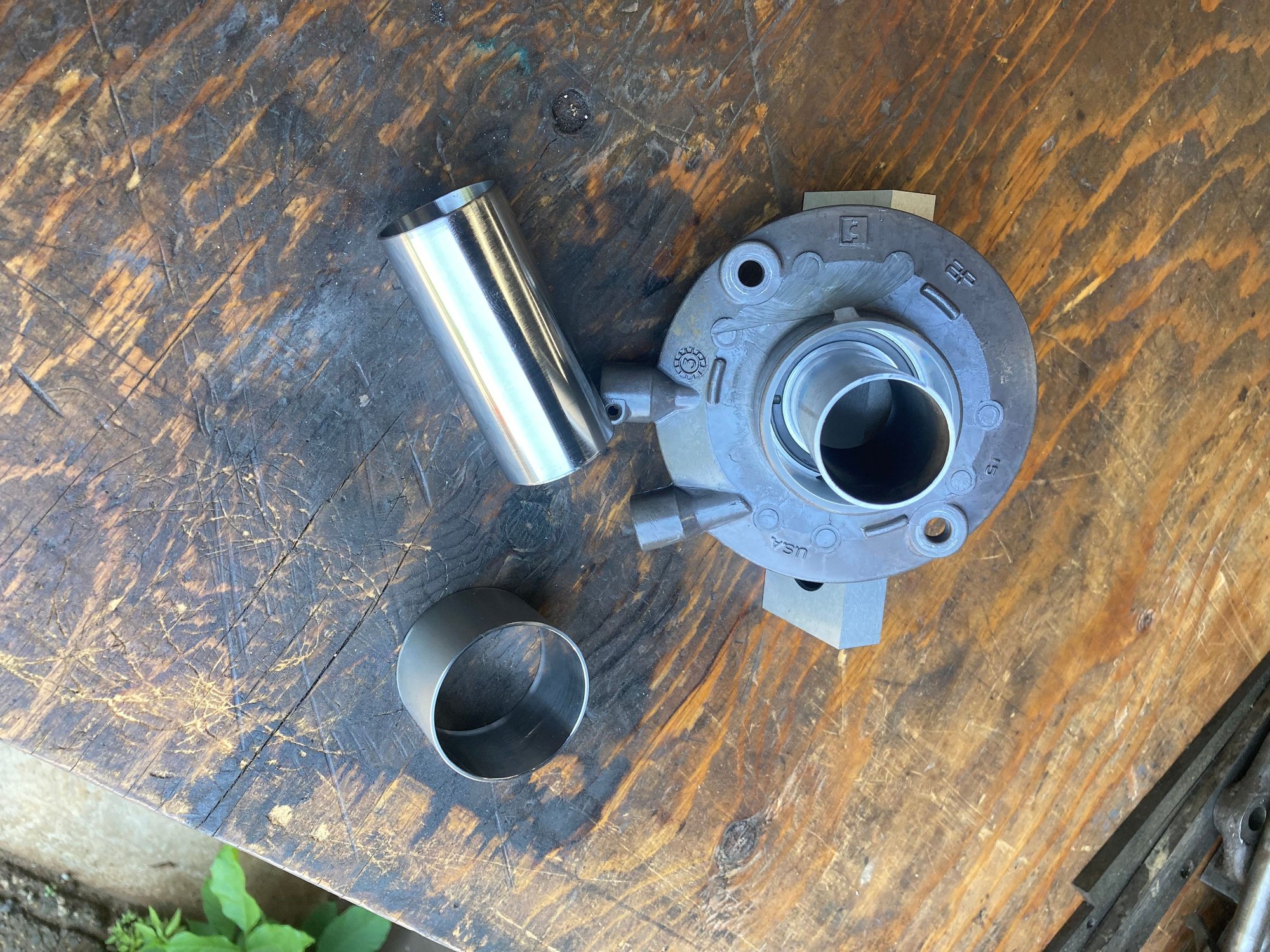

New slave for template
Machining for sleeves
Sleeves to go in
Sleeves in

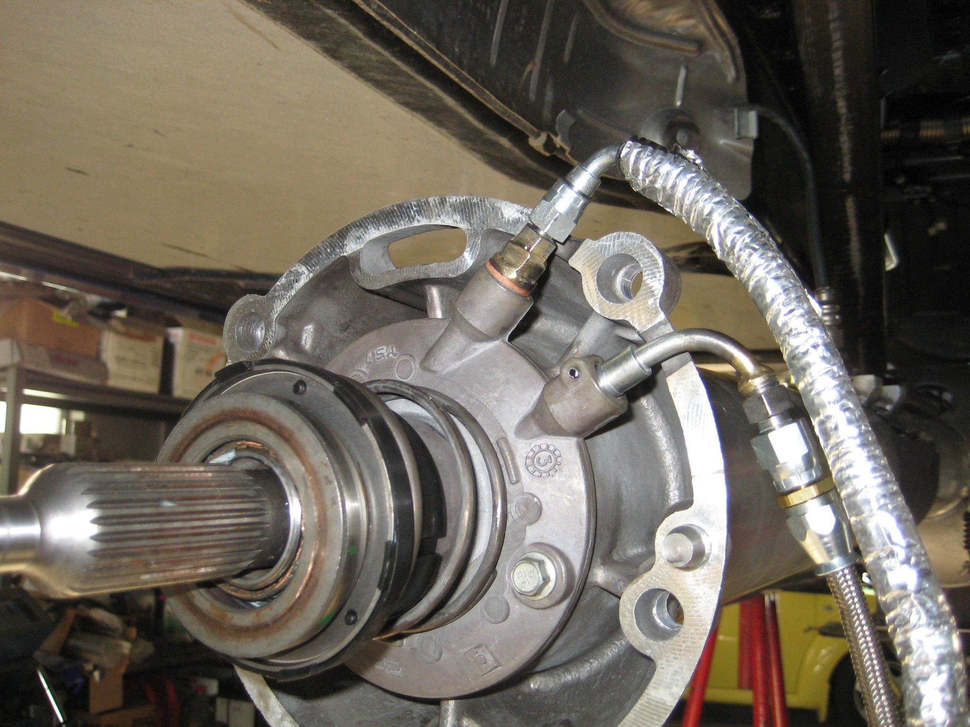

On tube

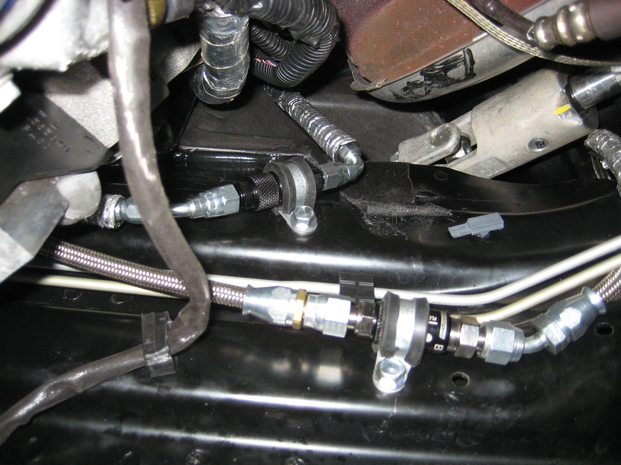

Re-located slave lines with dry break connectors

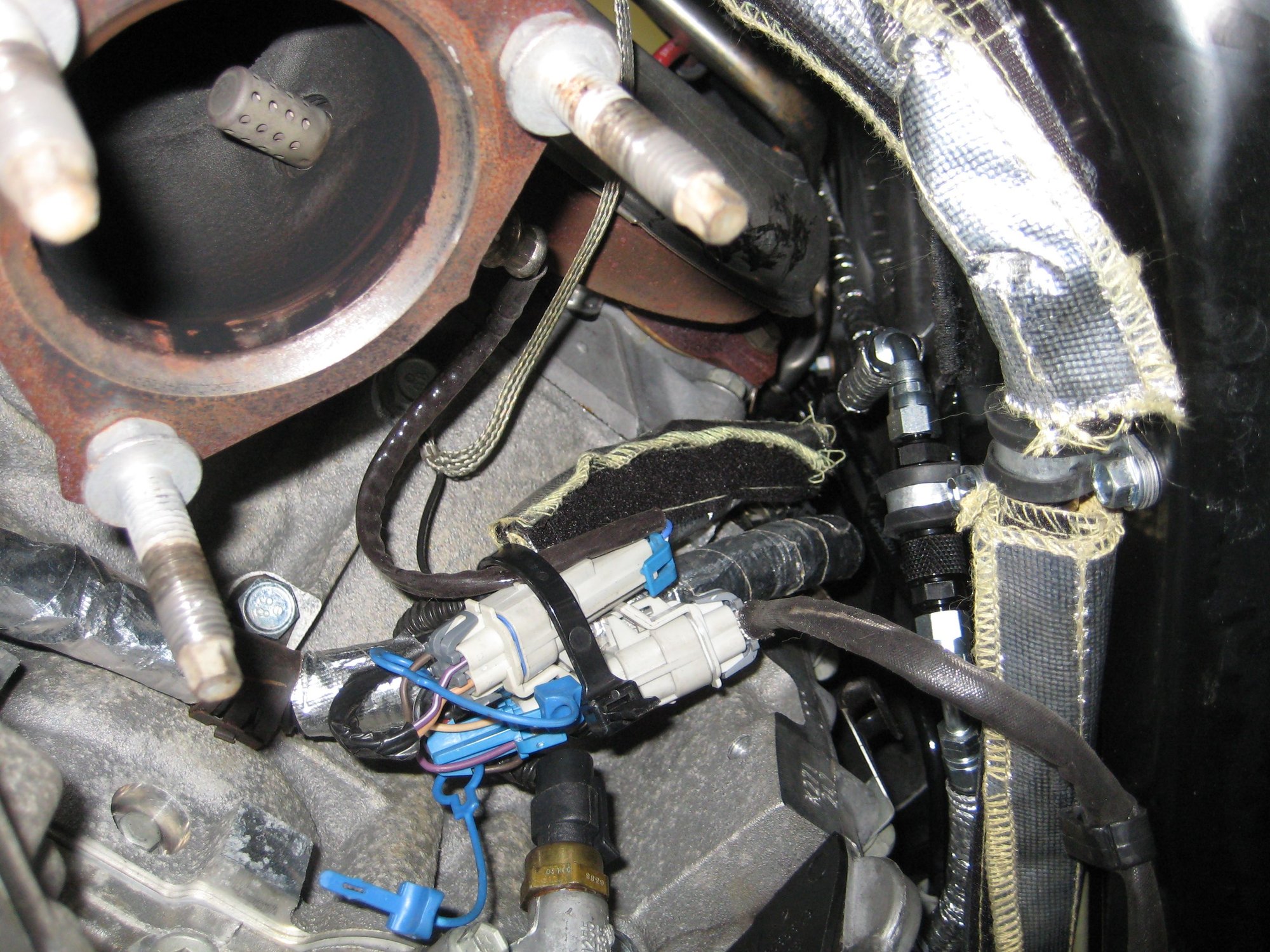

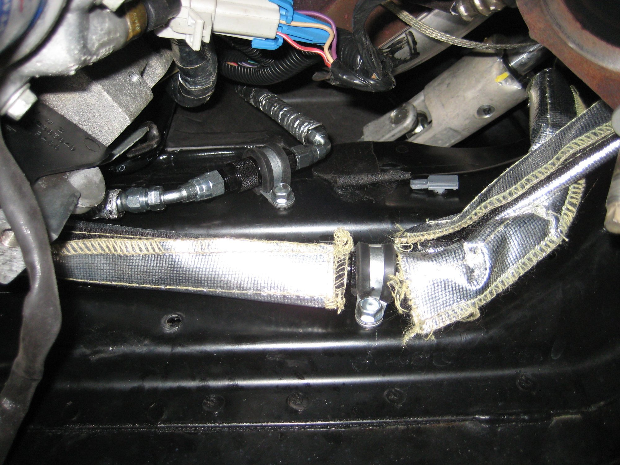

Found some velcro heat shield for line
Re-located O2 wires and tied up.

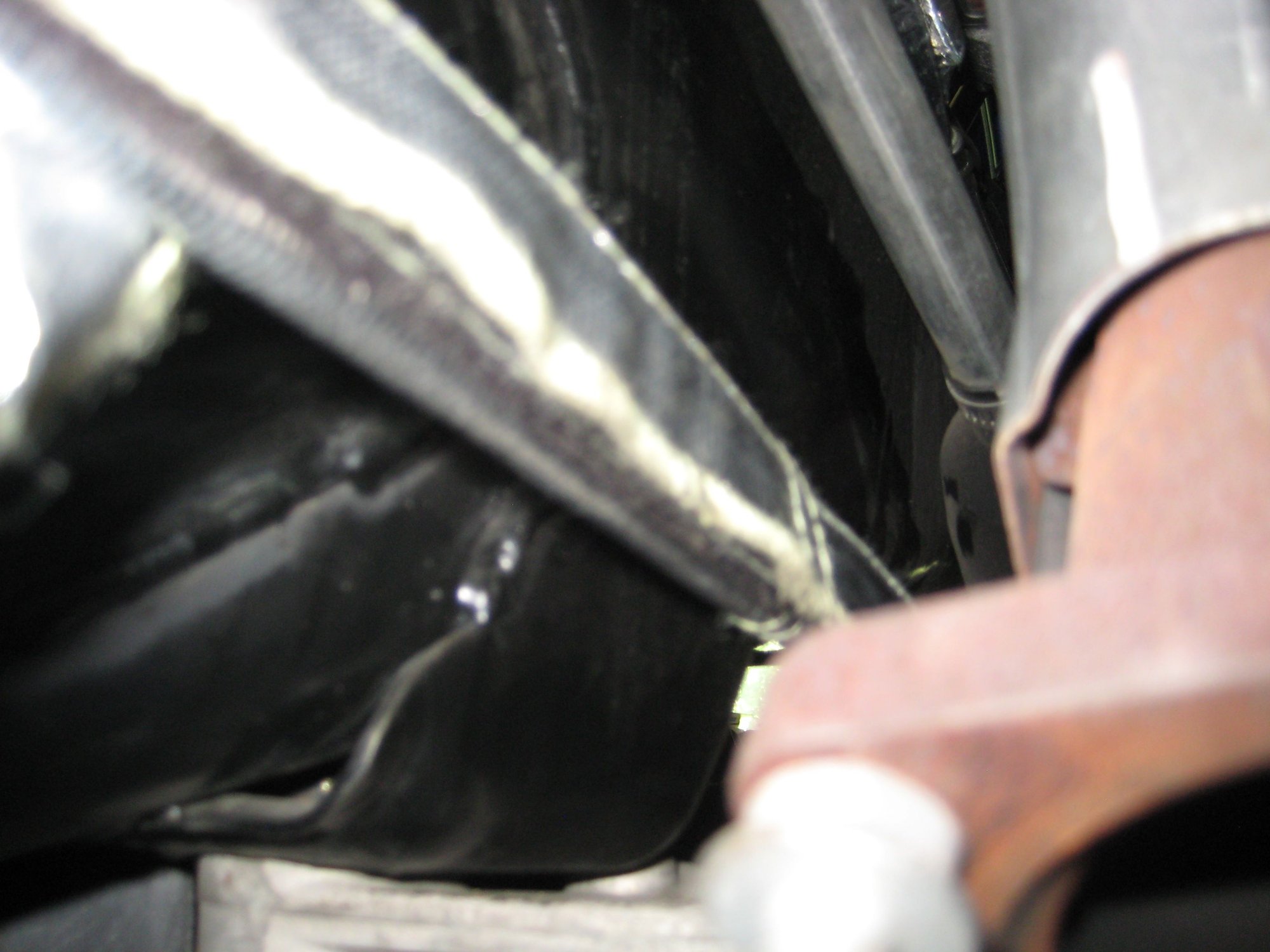

Put some heat shield on brake lines also.
