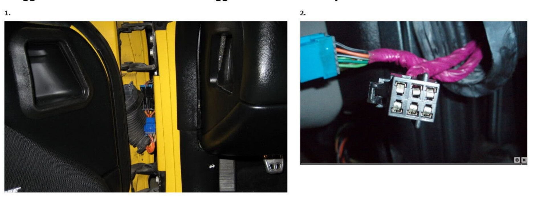

If you look on the connector you will may see some contacts with more space then others . These could cause problems .
If some of you contacts looks like this try to bend/pry carefully with a small screwdriver or similar to close these gaps.
Everyone should look like upper left contact set.
