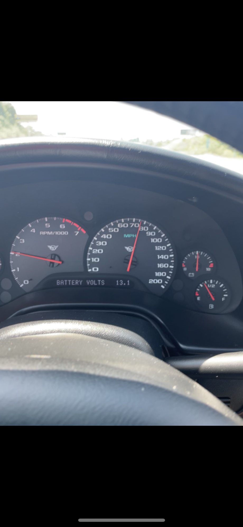

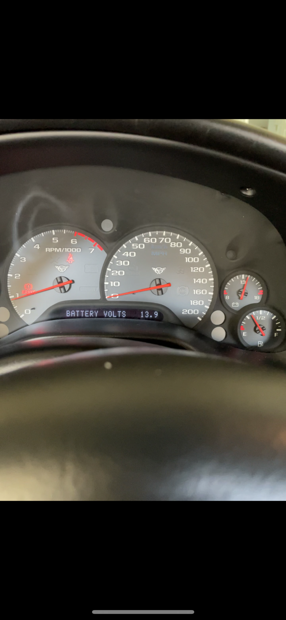

New starter fixed the problem ! As in my above pictures the connection point on the solenoid broke off So I’m assuming it has been worn for awhile causing a bad connection and finally snapped when I started removing the starter. Below are all the things I checked
alternator, harness, fusible links, battery all which seem to be good and passed various tests
below are pics of my gauge reading , I’m curious on the 2nd picture is it normal to drop to that level after some time ?
When I initially started the car with new starter
After driving on highway for about 20 mins, seemed to stabilize here

I wouldn't expect that. Mine is usually around 14V on the highway.

Lower than I'd like to see. Test your battery. Put a voltmeter on the terminals when the car is off. Anything over 12V is good. Also, take that wonky mechanic crap off your alternator wiring. Then report back.

battery read around 12.34 earlier, and yes I took the wiring off prior to installing the new starter lol

I didn't think to suggest it, but check the voltage between the alternator output post and the battery positive terminal again.
