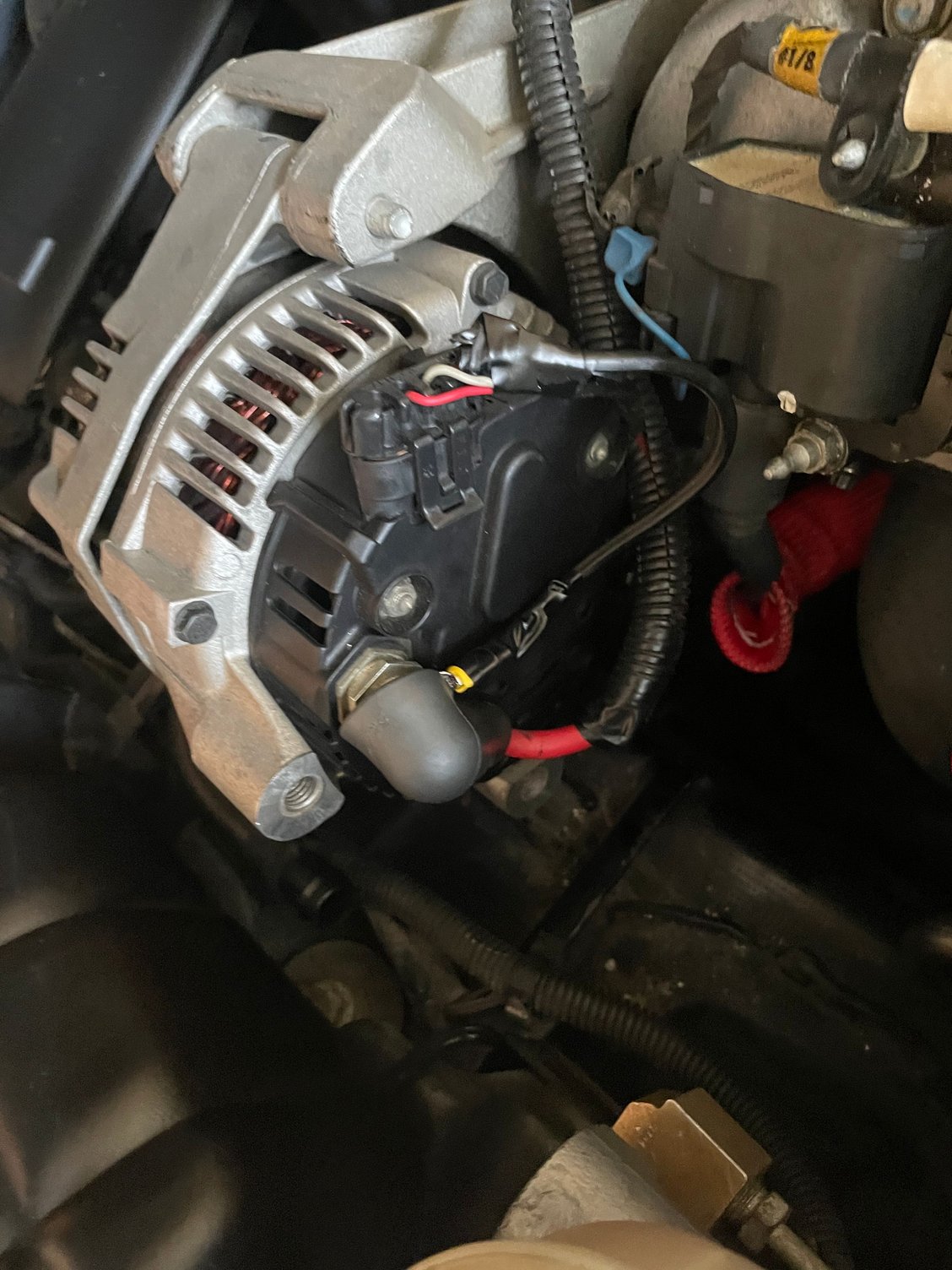

So about 3 days ago, I drove my 1998 C5 to work, on my gauge the battery voltage read 13-13.5 all the way there got back in my car after work, car through a charge system fault message then voltage read between 12.3-12.7. Parked at home, once I got back in my car later that night battery Volts read 11.2-11.4. At this point I know somethings off Woke up to drive to the advance auto, at made it but barely volts dropped below 10 and gauges shut off. So basically my alternator was not charging the battery or providing power to the system. Before doing any real research it seemed obvious to me and the guy at the parts store who was an old mechanic that it was the alternator, so I purchased a new one and put it on, still wouldn’t charge. I then realized I can get my original alternator tested on the machine and it came back good (wish I did this before wasting my money ) . At this point I needed to get my car towed, the tow guy came out and being an old mechanic, did the trick In the below picture, my alternator started charging everything again ! so this tells me something is wrong with the wiring or harness. The next day I started the car up and it immediately read 13-13.5 volts but it would eventually after 15 mins drop to 12.7 then after another 10mins to 11.4 then stabilize at 12.4-12.7. So this worries me that something is still off. why would it drop from 13 after driving, all the way down to around 11.4 just to go back up and stay at 12.7? Battery is an ever start built in 2019.
btw I took off the starter to put on headers a week before this started happening. No issues starting the car,
also can anyone explain if the temporary fix the mechanic did will cause an issue ? He said it would not be an issue and I could leave it like this or search for the issue through all the wiring.
Inserted the black wire from connector (far right red wire) to big wire under boot

Could very well be the alternator wire connection at the starter solenoid, also best to check voltage with a DVM across the battery terminals.

Put the wiring back to stock and clean the connections at the starter solenoid and see what happens.

Yes, most likely the solenoid connection. It could also be the wire from the alternator to the solenoid so check the fusible link while you are there. Feel it for rough spots and also make sure you can't stretch it.
Don't just tighten it. Take it apart and clean the lugs before putting it back together. You can put a bit of grease over the lugs to help protect them if you want.
