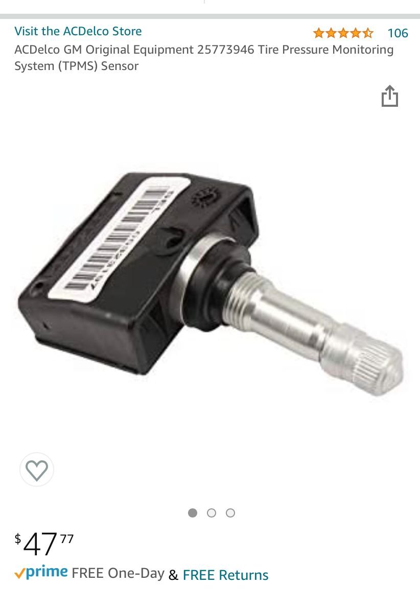

This is what I put in.

By the way, make sure they are for the right year! Those are for a 2002-2004. They may not be good for a 97-2000. I am not sure what year your car is.

Depends on the year of the car to determine what sensors you need

The 97-2000 sensor is different. They are still available, it seems.

Nice car. If it were me, I would get the OEM for that year off amazon. May be more expensive, but they at least should work. You need the 97-2000 tpms
