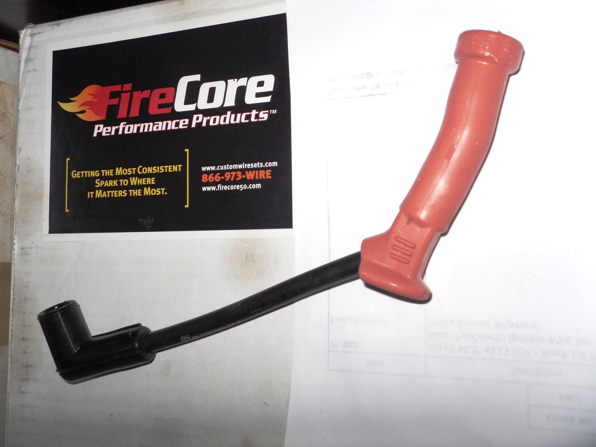

I believe this is where I did a set. they used firecore cermic and custom made the length. Different car, really good stuff and has lasted for years.
https://www.customwiresets.com/home.php
I'm considering do this as well to mine to also relocate the coils.

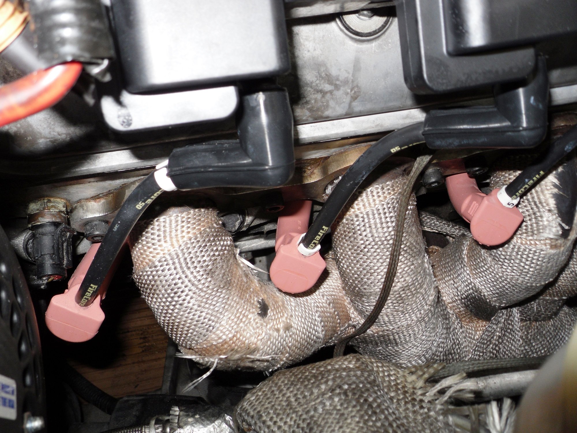

Those are cut to length with the boots my engine needed, best on the LS market:
