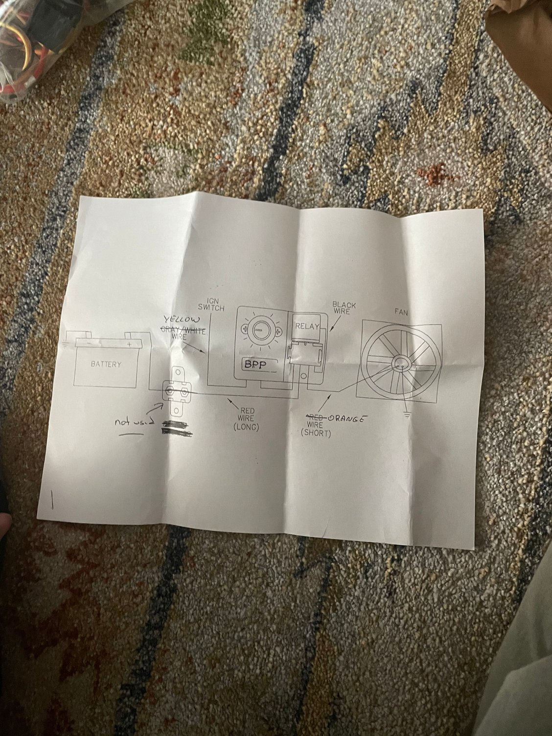

I purchased this kit from ZIP: https://www.zip-corvette.com/97-04-adjustable-fan-controller-switch.html
The goal is to optimize my cooling along with a new 160-degree thermostat. Now that I’ve received the kit, I simply don’t understand how that works. I’ve never used one of these before but as much as I understand how to install it (see the only document provided along with it, which doesn’t mention the probe but that I assume goes to the radiator) I don’t get how I’m supposed to dial-in my own on/off points.

170 bucks for a mystery box with one photo of a pile of spaghetti, no documentation other than an MS Paint block diagram....just send it back and clean all the road junk out of your radiator. There is no need for all this add on jibberjabber.

The fan control is pretty complicated. There are three relay's used to control the two fans. The diagram is only for one fan. It does not look like it could even work unless you completely rewire both fans. If you just need to control the fan turn on and off temperature's get a cheap used hand held tuner and you can program it yourself.

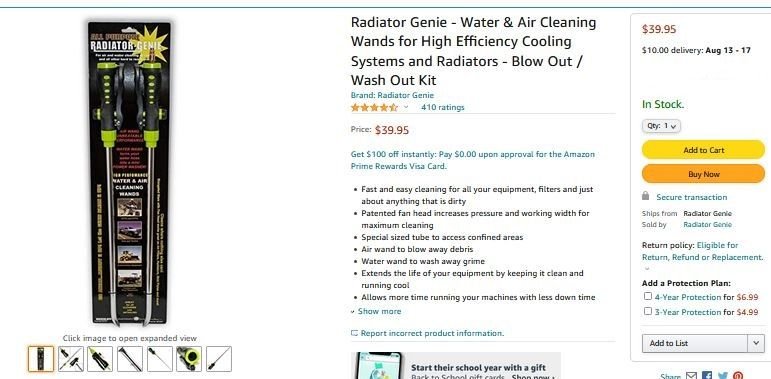

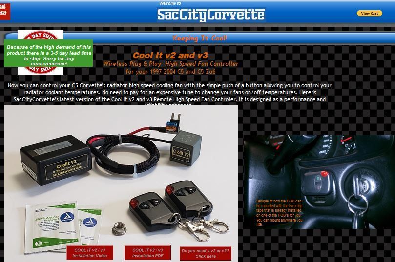

I run stock stat/fans etc and I am in Florida. No problems over heating, as others have noted, so there is something to sort out. I would start with a radiator rinse (cheapest option). Even on my low mile car I rinsed out a noticeable amount of dirt from my radiator, and have seen pics of some other cars that were full of trash. Attached is a pic of the model I bought off Amazon. You're going to need one anyway even if the problem turns out to be something else. Below that, I have attached a pic of the remote controller from SacCity Corvette; this one is a hell of a lot simpler to install and use (about $120).
Bought this on Amazon - uses water or compressed air

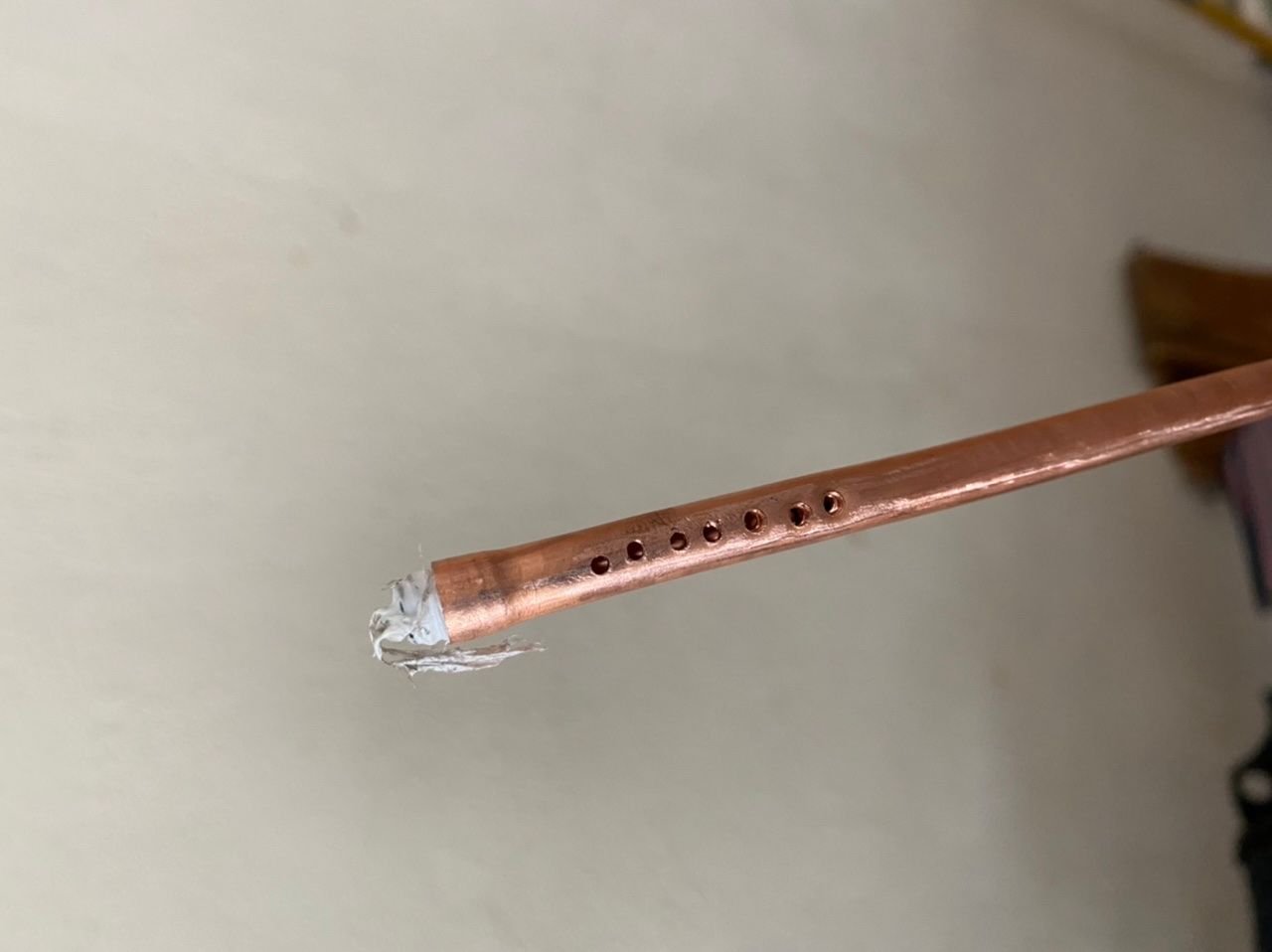

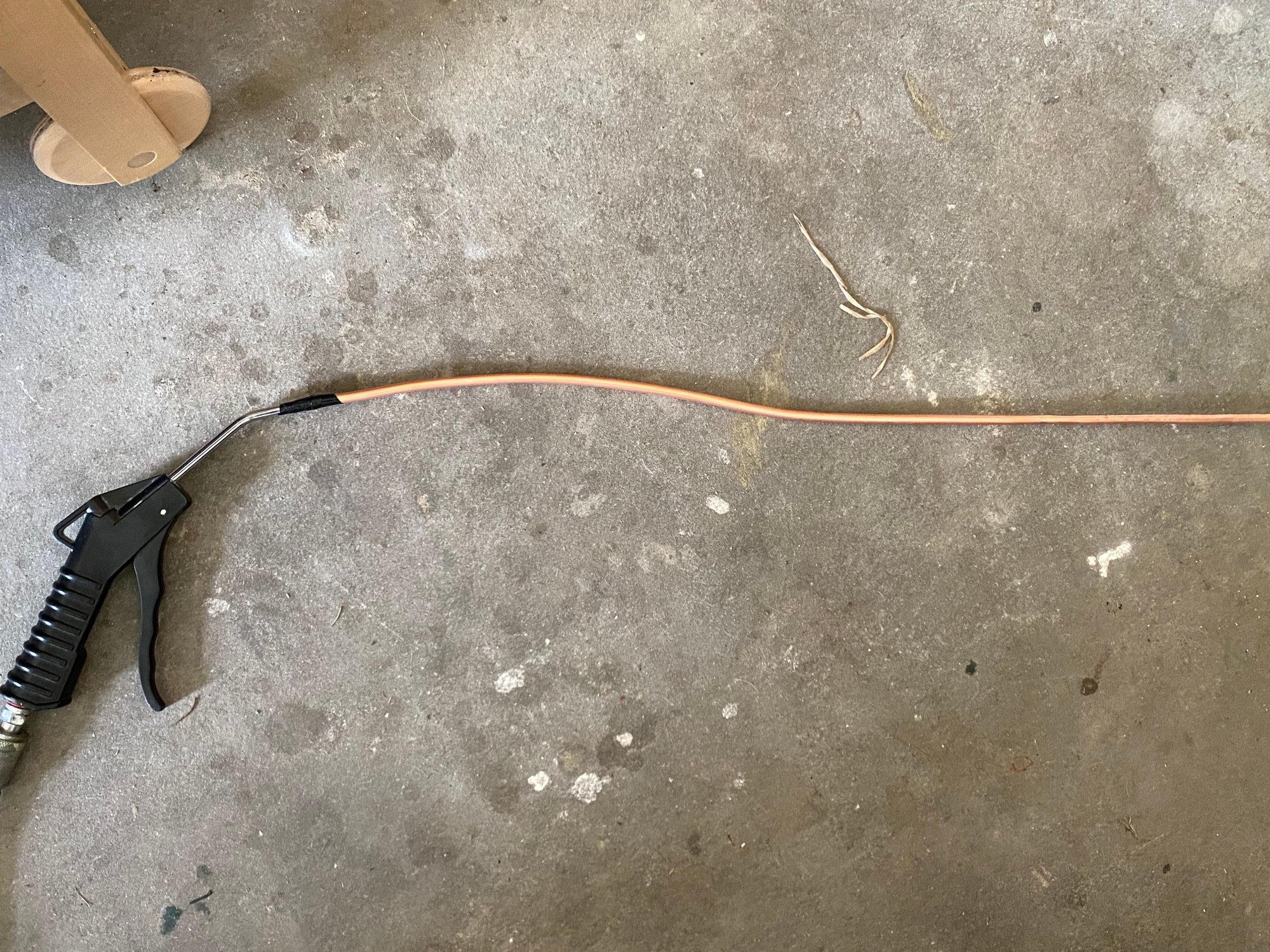

Or for four bucks just make your own:
Piece of 1/4" copper tubing from home Depot electrical taped to air gun tip. Couple tiny holes drilled in the end. Cap with a random screw and some Teflon tape. The copper tubing is soft enough that you can just screw the screw right into the end.
Way longer than the Amazon attachment and nicely flexible enough to reach every book and cranny.
