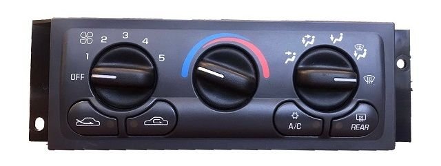

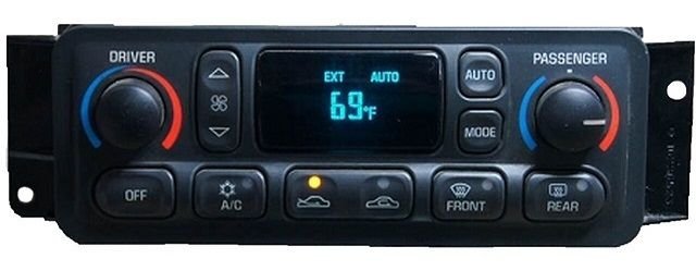

Leggy Pete, you didn't mention whether you have the automatic HVAC control or the manual HVAC control.
Automatic HVAC Control
Manual HVAC Control...
I have been having a similar issue with my 2000 Hardtop with the manual control. Unfortunately the manual controller is no longer available so you'll be stuck finding a used replacement. I believe you can still find a new automatic controller if you search for it. I found a used manual controller for my car and replaced my original controller with it, but the problem has persisted. Until I resolve the issue, I'm disconnecting the battery if it it isn't going to be driven for a few days.

Hi
sorry it’s the auto unit
