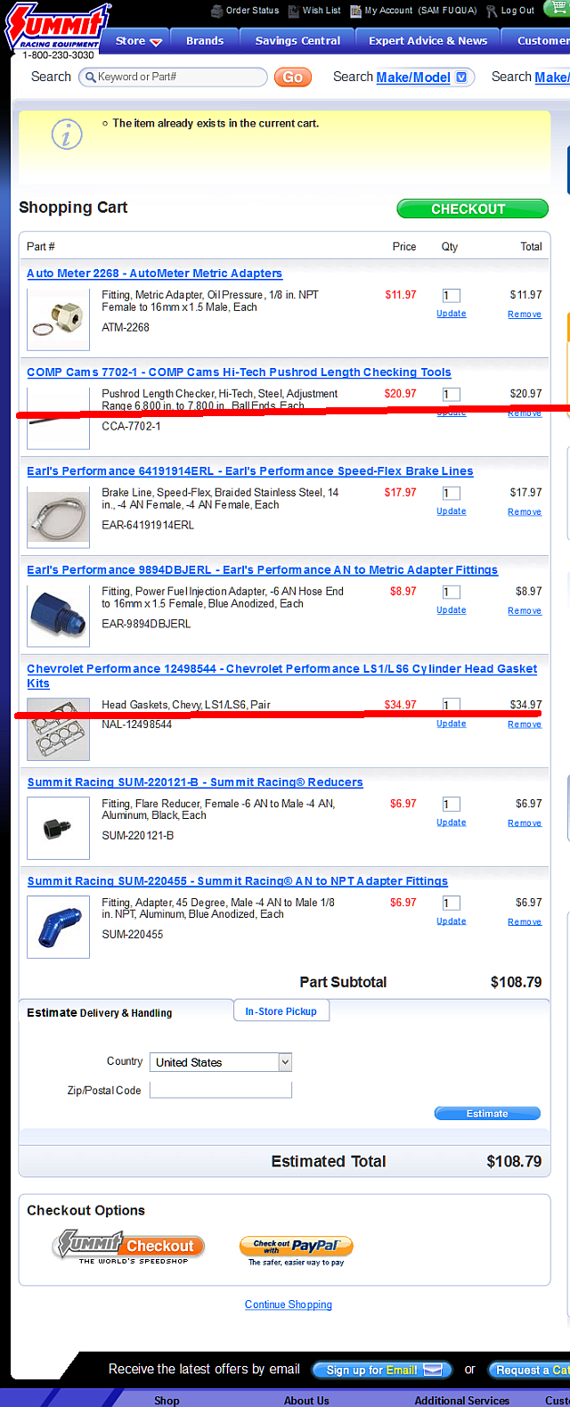

Here is the parts list I used to relocate mine
