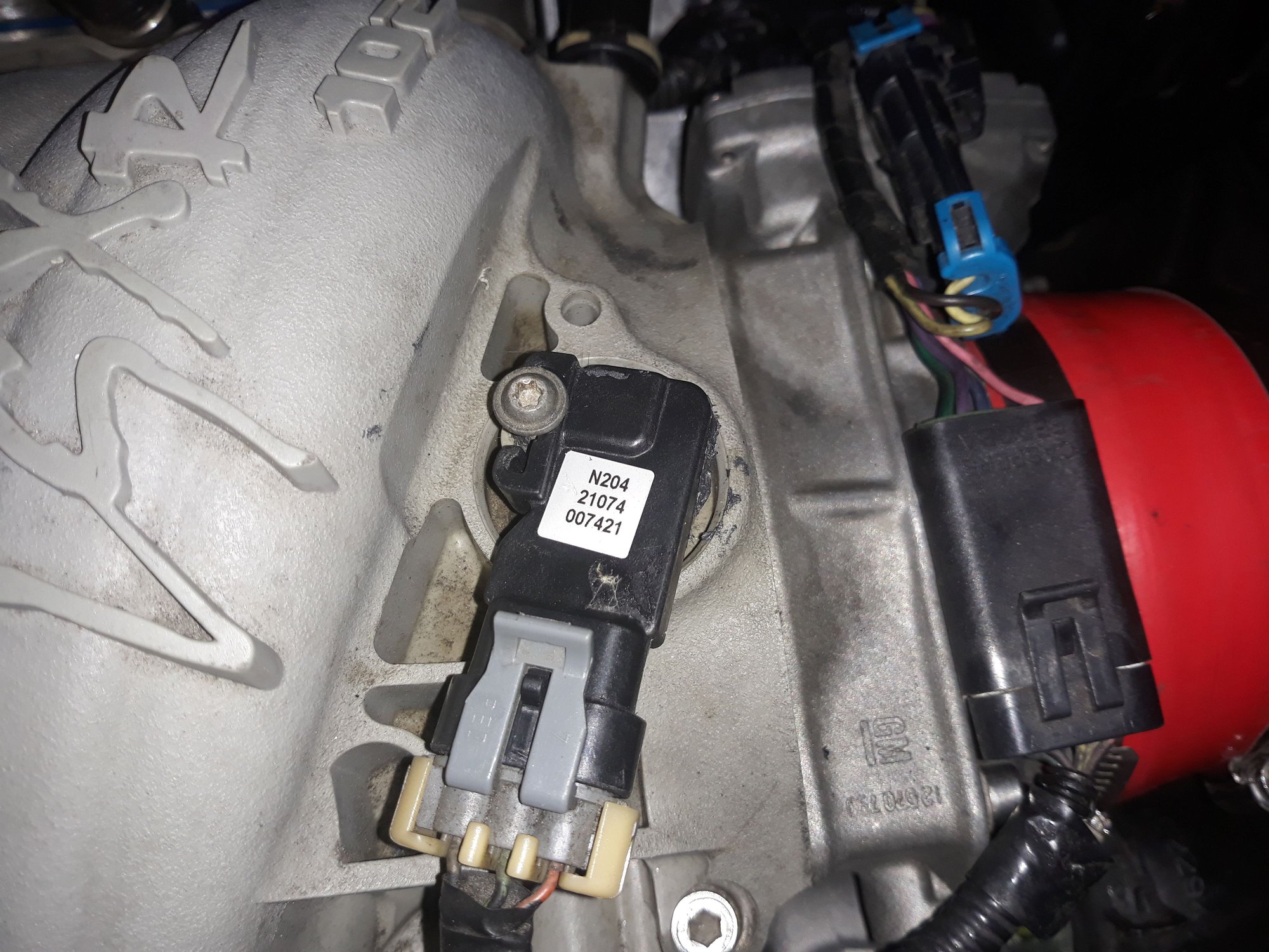

IS this a 1 or 3 bar map sensor, I am having a lean condition in upper rpms under boost.
I changed out o2's and the MAF, This should not affect the tune right? By just changing out the same parts?

The part # shows it to be a 1 bar

wow ok so this was in my original tune, I guess the fuel trims were going off the MAF.
This is whats on the car now, not sure what the brand is or if it is a 1 or 3 bar. Can anyone help me?
