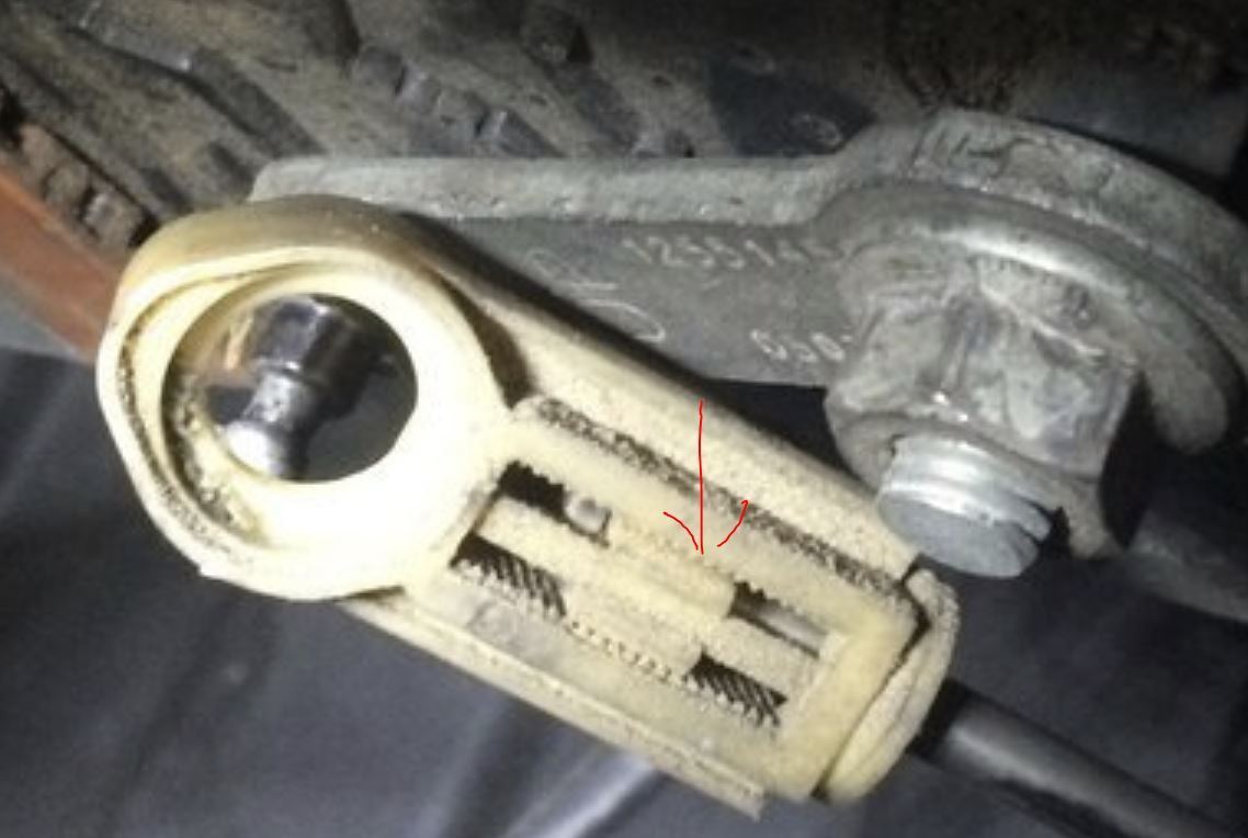

It happened to me backing out of a shopping center parking lot, nylon bushing broke at the transmission. Tow company had to slide the rear of my car over to get it straight before they could load it. Was a huge PITA. Went ahead and replaced the whole cable myself, wasn't hard just time consuming. Be extra careful at the shifter, you can break the cable. Preventive maintenance is best in this certain case. My car had 60,000 miles on it.

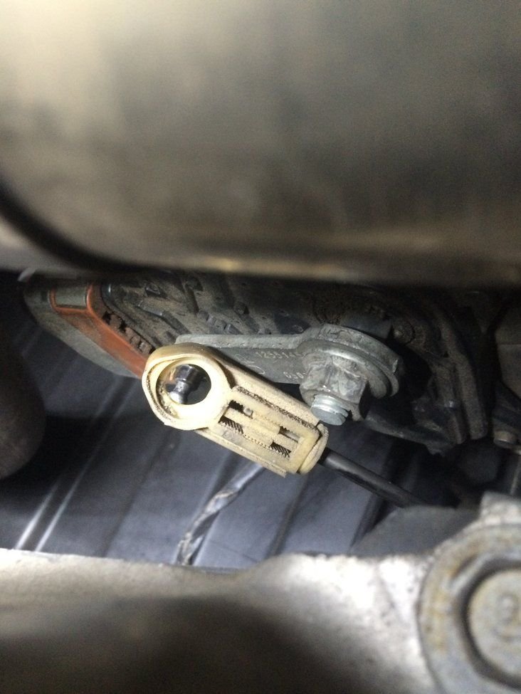

Just had my cablle bushing go when my wife drove to work 35 miles from home. Read various threads, went to autozone and got Dorman part 14057 as well as a low rolling jack, both totaled under $100. Jacked the car, found the bushing was loose at the tranny just like the attached picture from Yello95 depicted. Wedged my fat hand in between exhaust and transmission, and squeezed bushing into place. Threw the jack under the back deck, and have peace of mind should anything happen in the future. Good pictures here: Post # 6 Linky

Now --- gear indicator shows 1/2 red & 1/2 white for most gears including Park. Shifter can't travel back all the way down to the rear to 1st gear. Is there an adjustment on the cable, shifter, and/or trans to correct the slack to allow the proper cable & gear?
Took off the shifter indicator top to see if the red part was perhaps broken. Nope. It's the cable vs. trans position.

Not an expert in any way, but here's what I found when I replaced the cable on mine. The selector and transmission are both supposed to be in Neutral when cable is connected. There is an adjustment on the cable, visible in the picture I posted above where it ratchets tighter. The piece I'm referring to is the plastic piece below the screw in that picture. I believe you can loosen the ratchet plastic and adjust to get correct. May well be wrong, just my thoughts.
