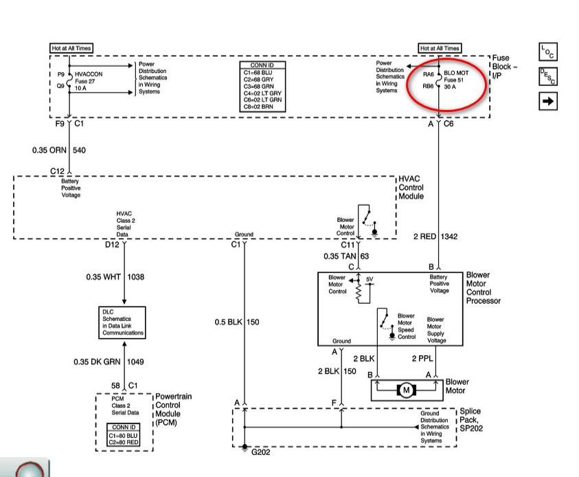

The first think I would have done is to check/measure if Fuse 51 is ok or not
This fuse is feeding the blower control .
