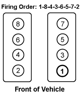

Which cylinder on my 98 LS1 is cylinder2? I have a code for misfire on that cylinder and will probably get a new coil pack and wire after checking the spark plug unless there's another cure

Cylinder #2 is the passenger side front cylinder !!…coil packs rarely go bad…do you have a scan tool ??

Thank you. Once I found out which cylinder was #2 I found the plug wire had come off the coil pack. Easy fix and I am back on the road. Thank You Gentlemen for your help.
