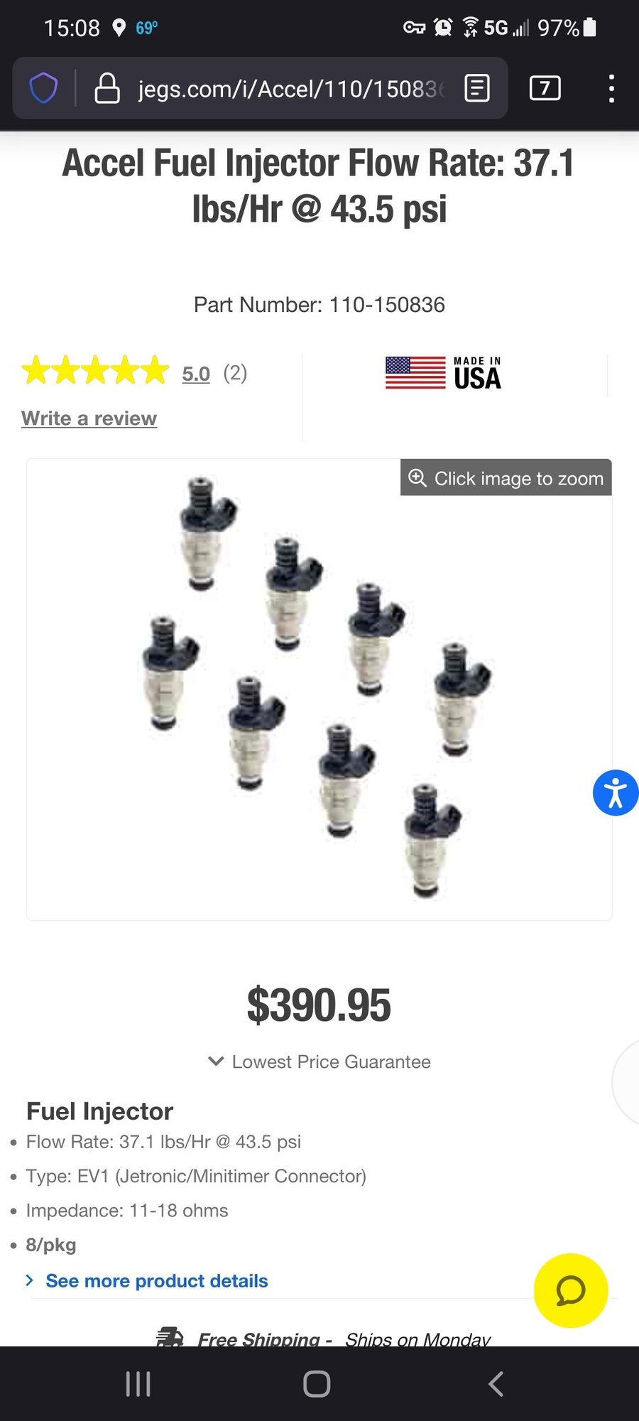

I am looking for a LS3 height 42lb injector with the EV1 style connector.
I am building a LS3 motor in a 2002 C5 with EV1 connector harness. Should come in at 525-535 HP. LS3 fuel rail and intake. I want a plug and play injector with no mods or adapters on either side. I have found what I think will work, but I am always up for more input. Thanks.

These are the ones I ended up purchasing. No adapters needed at all. They are good to 650hp. There are a few different companies that make their own versions. I looked at several, but decided on these.
I hope this helps others to know you do not have to risk leaks, or fire due to a faulty adapter or seal.
Don't get hung up on the poundage of the injector, you will choose the wrong size of you do, as most do. Pay attention to what pressures they are flow rated at and go from there.
