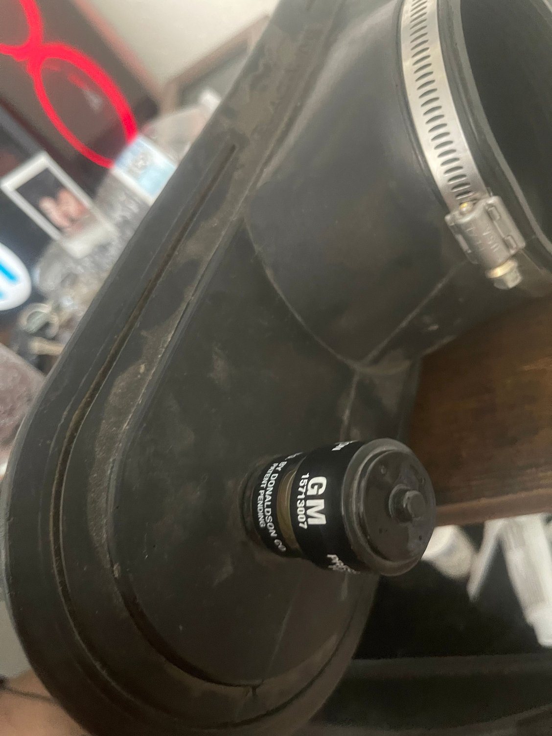

I just recently bought a slp black wing used for a good deal but I noticed it don’t have a whole for the vacuum and has a spot for a filter rest or something idk I need some help can I just take it out make the hole bigger and install the vacuum hose thanks
There’s that little sensor thing should I take it out and make the hole bigger for vacuum hose

You can get rid of it, it is not needed. It's an indicator to show if your air filter is restricted.

I have a 98 vette recently bought a intake bridge and what do I do for the fuel regulator line just make a small hole in the new coupler and just stick it the hole ? Thanks

Yep, pretty much what I did. I used an awl to make the hole. Pretty easy.

Although the filter monitor is not needed I would just add the additional hole with a hole saw or Forstner bit. Especially if you ever decide to go FI or upgrade to a Vararam, and want to sell the Blackwing.
I have a Blackwing with the air hole and elbow (which I capped with a rubber cap) because I removed the air tube from my car. Depending on where you are (if local to NJ) I would trade you the one I have for the one you need. I don't really need either (I am FI now plus I have a Vararam if I go back to NA).
