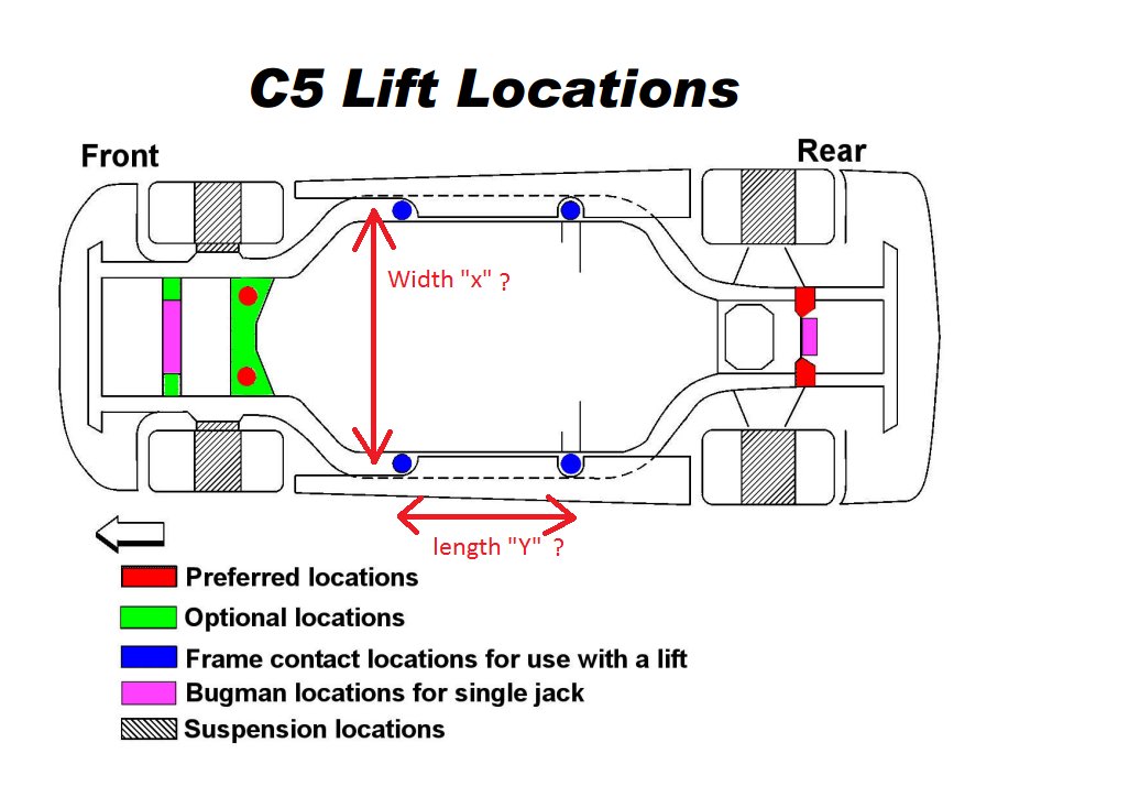

This is what I have on file regarding the jacking points on the C5.
Posted jacking info by another forum member.
