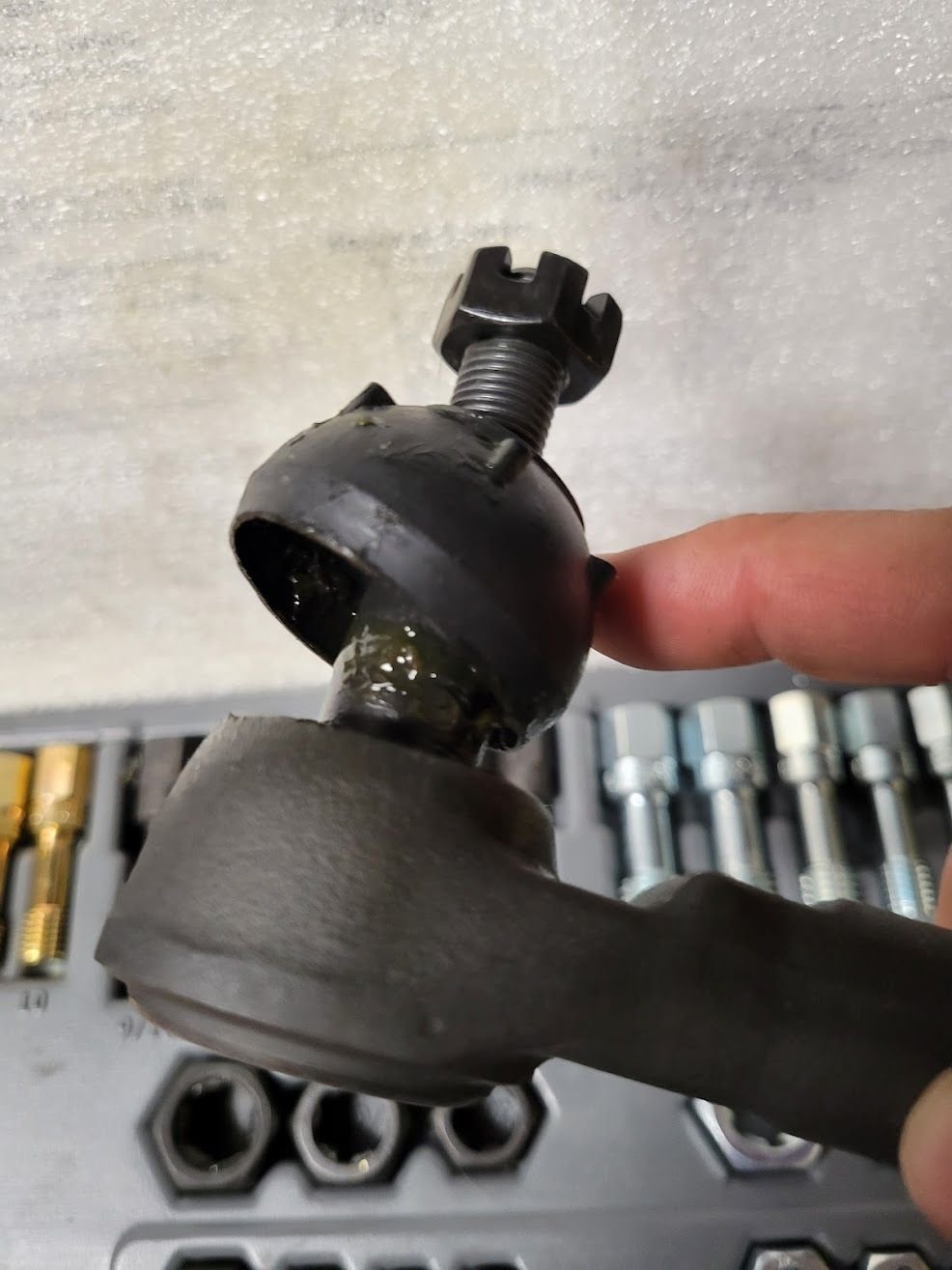

Received a set of rear outer tie rods from Ecklers and noticed that the boot isn't attached to the base. Should I be concerned about grease leaking out once they are properly greased up and installed? Seems like they would seal OK once snugged up. First time I've seen tie rods that didn't have the boot secured via circlip or snap ring

nope, no concern the knuckle will hold it. You want it to allow grease to squeeze out when you grease it. Normal.

Cool thanks for confirming!
