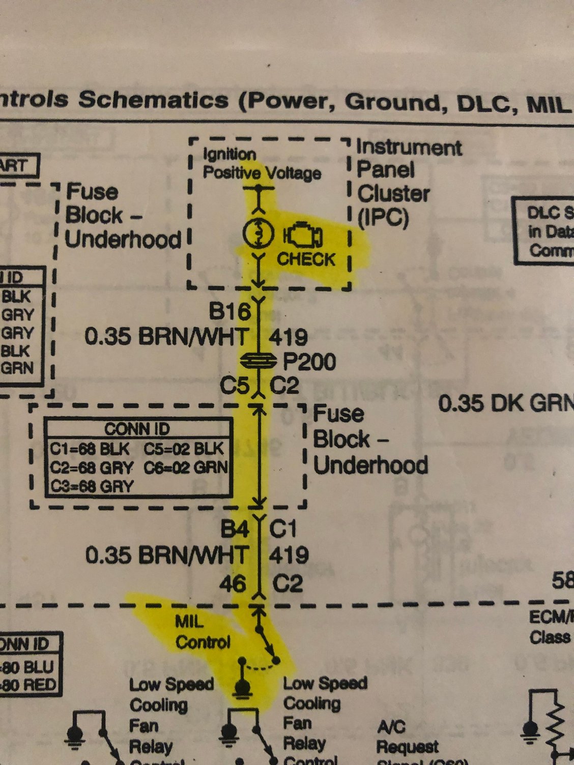

Power for the bulb is supplied at the IPC (IGNITION 1 voltage) and the PCM grounds the circuit there so it’s best to start at the “horses mouth” and see if the PCM is indeed grounding that circuit when you turn the key to ON…at the PCM the connector is C2 and the pin is 46 which is a brown/white wire…connect a 12 volt test light to battery POSITIVE and see if the light illuminates when you turn the key ON…if it does your issue may be power to the bulb or the circuit from the bulb to the PCM..looks like the circuit from the bulb to the PCM goes through the underhood fuse box !!…the wiring is from my 01. Maybe someone with a 99 can verify the wiring.
Yes, 99 is exactly the same.

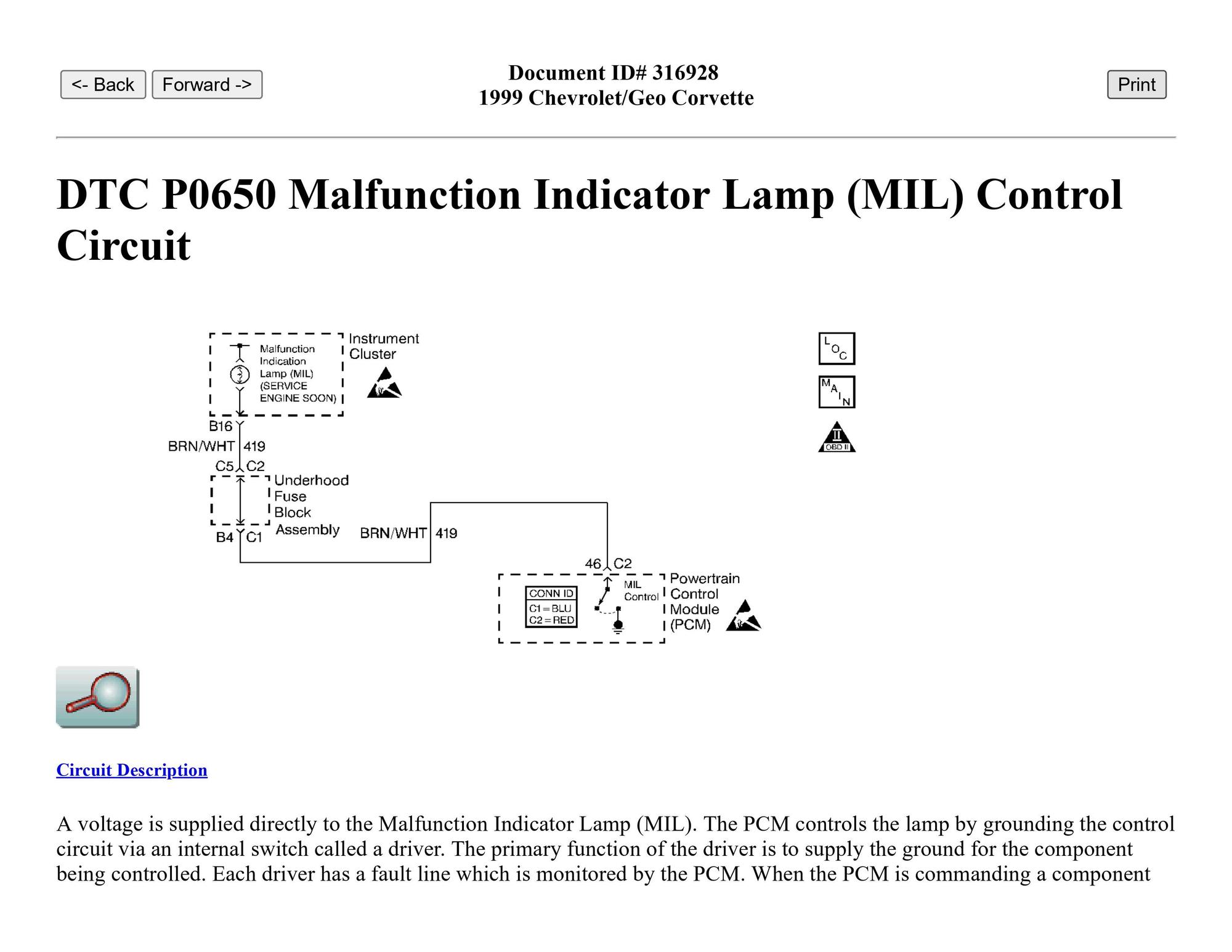

Are you getting DTC P0650?
