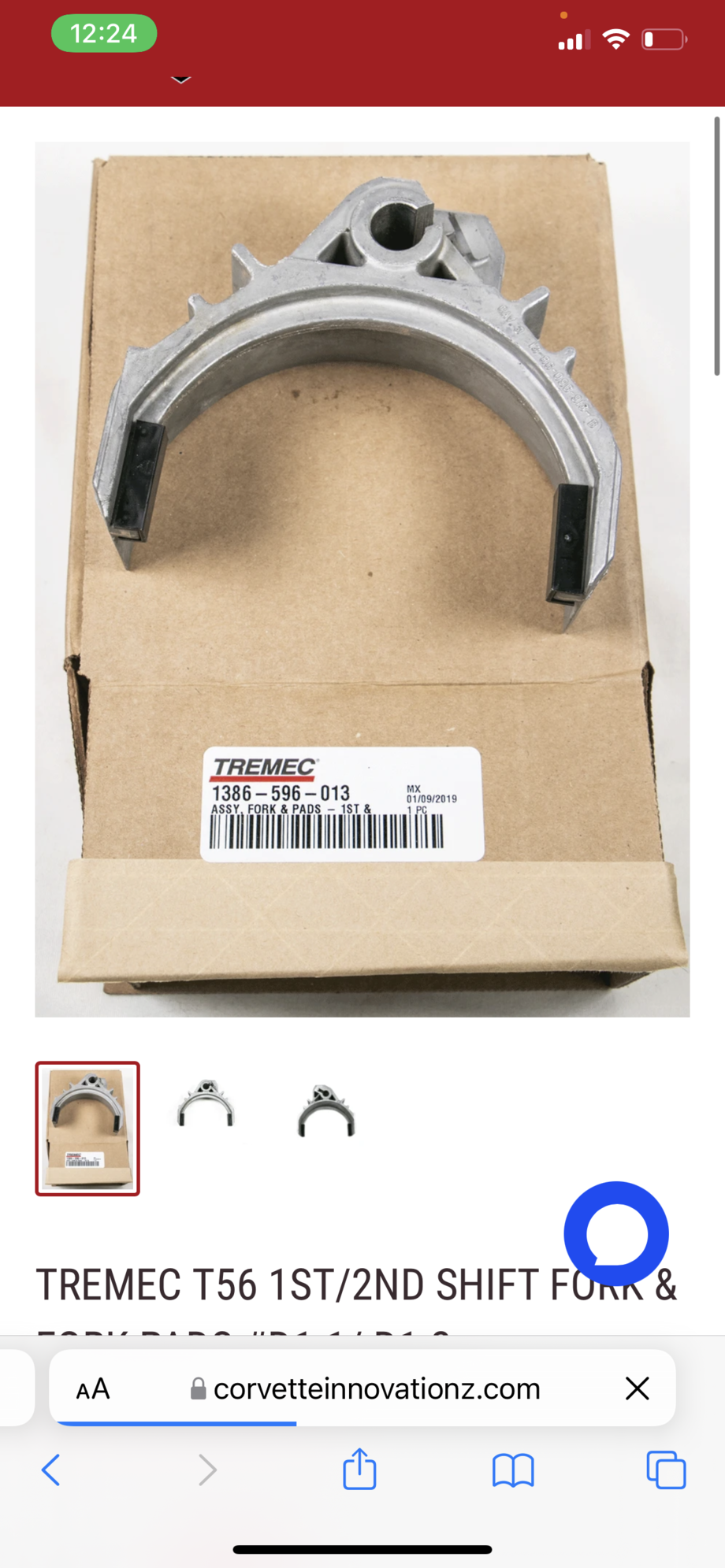

It was to give him the idea of the fork but here is the actual part I guess has failed
