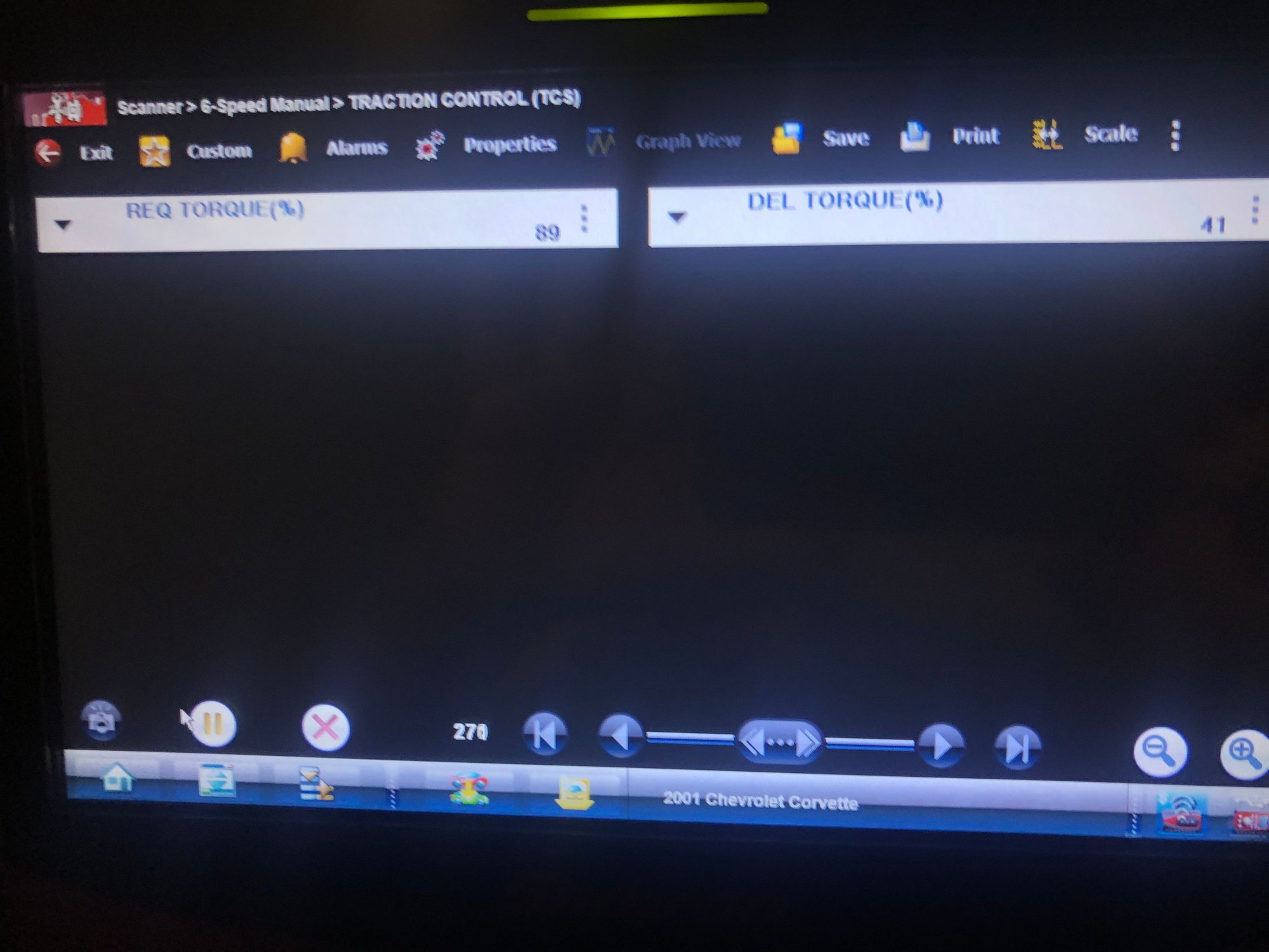

When the car loses power like that pull over and scan for codes through the DIC...you may see a C1276, P1644 or P1689 or P1277..the PCM is seeing the rear wheels lose traction or not seeing the right signal from the EBCM to the PCM (requested and delivered torque signal which can be seen with a better scan tool) and it retards the spark timing and starts cutting off injectors...you can even try turning off TC and see what happens !!…that's maybe why you are losing power...it may be a MAF sensor but a scan tool will confirm this looking at your fuel trims but your TCS light should not come on...I'd also be looking at your O2 sensors with those LT headers...also please fill out your profile...model year, mods, tune, and location if you want to...you may be in the next town over from me...this helps us help you !!…below is delivered vs requested torque at idle…you should see around 90% duty cycle when TC not active and delivered between 10-90% duty cycle lower at idle and higher when driving !!

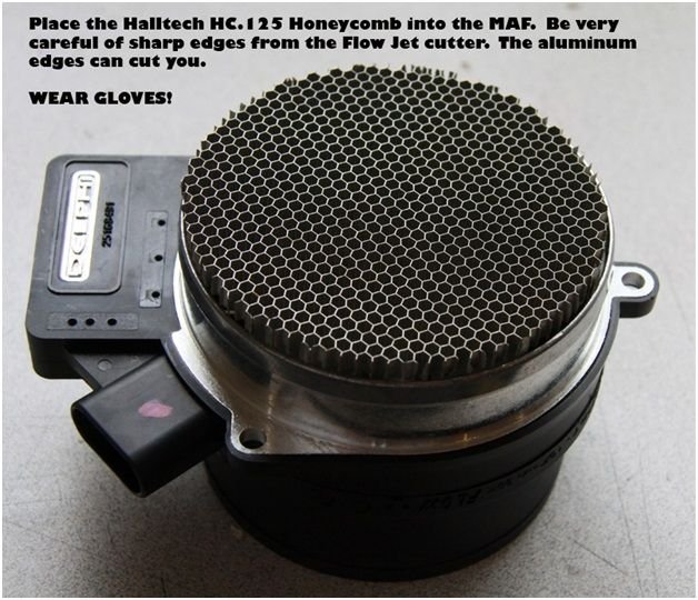

Is the MAF honeycomb air straightener still in place?

I am about to take it apart rn and clean the maf sensor and retorted evrything see if that helps I will see if that’s on there rn
